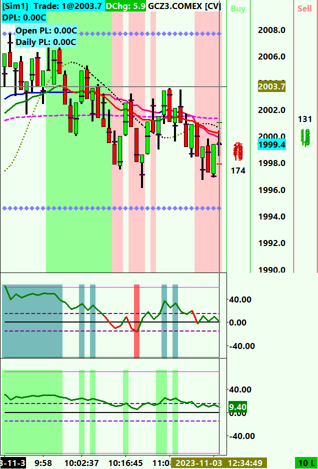

I have the DOM totals setup and they are working fine. However, when I try to do a replay, then the totals no longer display, nor does the entire 10 levels that I have the SC software displaying for the inside market bid and ask columns. Can I see the total size when using the replay function?

When you say "DOM Totals" are you referring to the sum of all of the market depth quantities, for the bid and ask side independently, currently displayed?

Correct. Here is a screenshot. https://www.sierrachart.com/image.php?Image=1699029948482.png The 174 total is the number of bids I have displayed, and, the 131 is the total number of the ask size. When I try to replay the chart, the bid/ask totals and all the sizes of the bid/ask are not displayed on the DOM. Let me know if you need to do a screenshare and I will show you what I mean. Sierra Charts are the best, in my opinion. Date Time Of Last Edit: 2023-11-05 22:57:20

It sounds like you do not have the Market Depth stored for when you are running a replay. Refer to the following: Replaying Charts: Replaying of Market Depth Data For the most reliable, advanced, and zero cost futures order routing, use the Teton service: Sierra Chart Teton Futures Order Routing |
