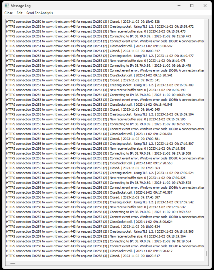

seandunaway - Posts: 398
i'm having the same issue, error 10060 spammed every few seconds, indefinitely. i'm still getting both quotes and routes successfully. i'm not sure if related, but i only began receiving these errors immediately after upgrading to 2561 arm64, and only after subscribing to a new symbol.
Date Time Of Last Edit: 2023-11-02 16:25:02
image10060-2.png / V - Attached On 2023-11-02 16:19:05 UTC - Size: 839.47 KB - 279 views
[2023-11-02 16:23:19]
% host -t a www.rithmic.com
www.rithmic.com is an alias for rithmic.com.
rithmic.com has address 38.79.0.89
% ping -c 1 38.79.0.90
PING 38.79.0.90 (38.79.0.90): 56 data bytes
--- 38.79.0.90 ping statistics ---
1 packets transmitted, 0 packets received, 100.0% packet loss
% ssh devel ping -c 1 www.rithmic.com
PING rithmic.com (38.79.0.89) 56(84) bytes of data.
--- rithmic.com ping statistics ---
1 packets transmitted, 0 received, 100% packet loss, time 0ms
seems like it's just on their end
Date Time Of Last Edit: 2023-11-02 16:28:11
