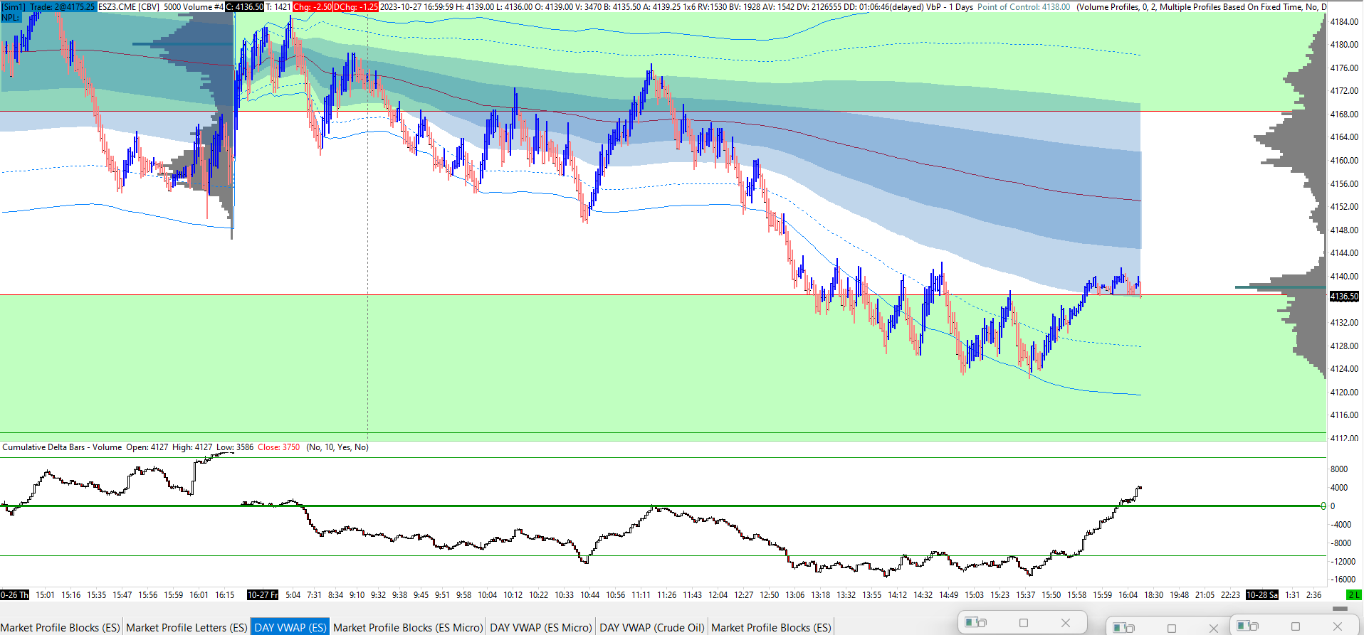

A while ago I had help with setting up my charts so that when an extending rectangle areaais drawn on the market profile chart, it also show up on the VWAP chart for ES-Mini.
I've been taking a look at crude oil and drew some extending rectangle areas on the market profile but they are not also showing up on the vwap chart.
Can you please teach me how to copy the extending rectangle drawings from my market profile chart to my VWAP chart?
Attached is a picture of what I'm trying to achieve.
image1.png / V - Attached On 2023-10-29 03:45:59 UTC - Size: 37.56 KB - 213 views
image2.png / V - Attached On 2023-10-29 03:46:06 UTC - Size: 82.33 KB - 204 views

Refer to the following:
Chart Settings: Copy Chart Drawings from Chart #'s (Chart >> Chart Settings >> Chart Drawings menu)
