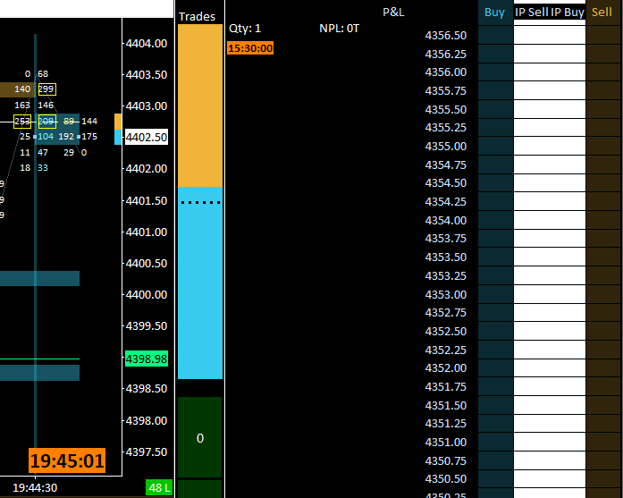

I have a problem with replay mode. Indeed, on the same Chartbook I do a replay of all the graphs for 19:45:01 and all the graphs are set correctly except the DOM which for some reason is set at 3:30 p.m.
For information :
- All my charts have the same "session times": 15:30:00 - 15:29:59
- I also did "Replay chart -> Reset replay control panel Window"
Does anyone have a lead?
Thanks in advance.
imageProblem replay.PNG / V - Attached On 2023-10-22 19:50:40 UTC - Size: 32.22 KB - 189 views
[2023-10-22 20:08:05]
User440951 - Posts: 54
I just found the solution, it turns out that in "Chart Settings -> Data limiting -> Days to Load For Intraday Chart Data Type" there was not enough day, 1 when I wanted to do a replay of 10 days.
I hesitate to delete the message, I leave the support decided.
This might help some...
[2023-10-22 22:38:36]
Sierra_Chart Engineering - Posts: 24908
Yes, that is the issue.
