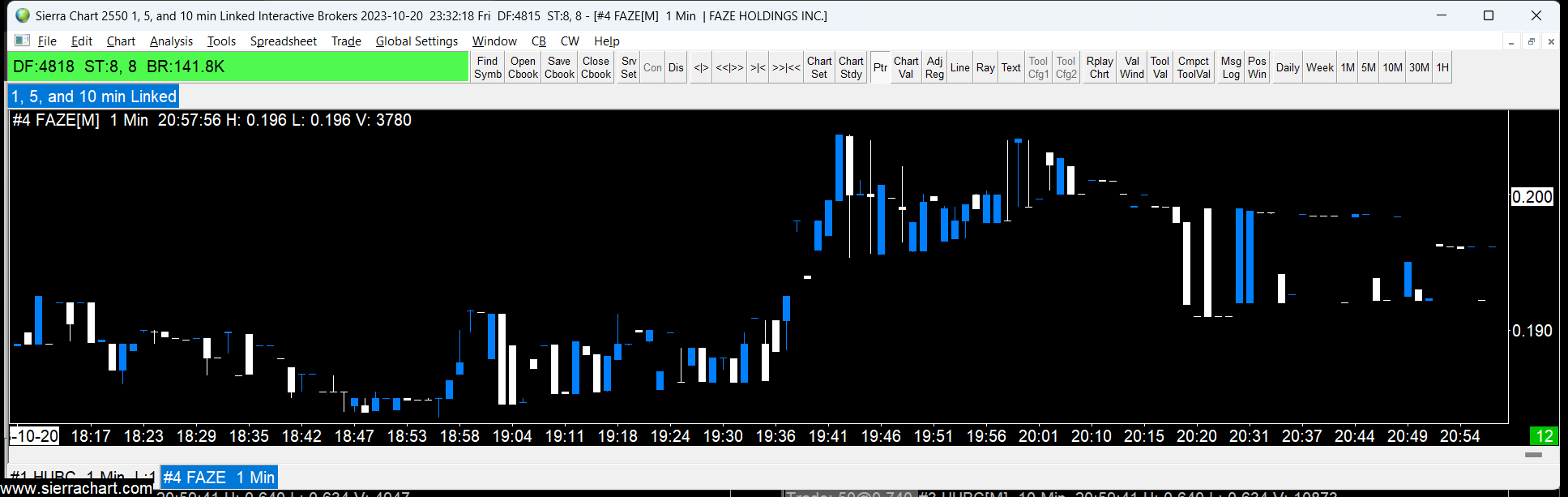

Is there a way to automatically have new symbols link to the desired link?
Scenario: I get on after doing my due diligence and am ready to day trade on market open. I know which stocks I am interested in and I would like to be able to have all of those that I am interested in on the bar as shown in the attached picture (as you can see the newly added symbol "FAZE" is not linked). I understand I can go through chart settings and just change it there, but time is everything for my style of trading. Being able to quickly transition from symbol to symbol would be a huge timesaver. Being able to switch through them and have my linked charts change to the respective symbol is needed.

https://www.sierrachart.com/image.php?Image=1697844739669.png
Refer to:
Changing the Symbol of a Chart: Using the Associated Watch List
And:
Changing the Symbol of a Chart: Combining the Associated Watch List with Chart Linking
