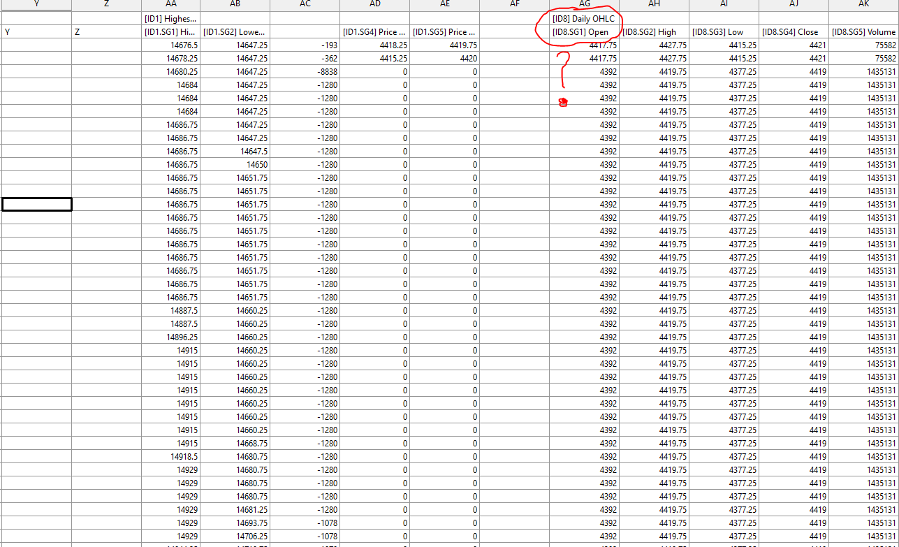

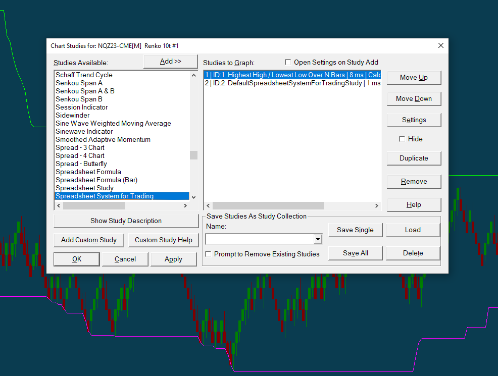

Hi SC,
I am trying to build an automation strategy using spreadsheets and Highest/Lowest Past N bars study.
When, I open the spreadsheet, it shows me a lot more studies in a spreadsheet, that aren't even on my main chart, why is that?
As far as I understand, spreadsheet should reflect the amount studies added on the chart, right?
Note, those studies are the ones I used previously, so could it be that has saved that as a "default" template for the spreadsheet?
How can I get rid of them?

[2023-10-21 15:52:27]
Sierra_Chart Engineering - Posts: 24908
Follow the instructions here:
Using the Spreadsheet Study: Clearing Old Study and Other Data from Spreadsheets
