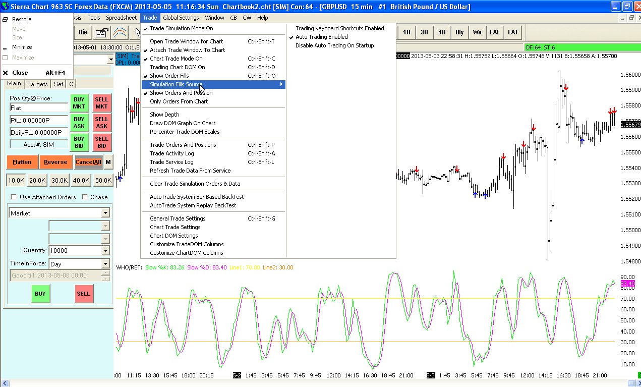

Here are my steps:
1. I opened SC with an FXCM live data feed (SC Forex data)
2. I opened a chart of GBPUSD 15m
3. I added stochastic crossover system that is already in the Analysis tab
http://www.sierrachart.com/image.php?l=1367745254976.png
4. Settings in Trade tab are as in attached pic

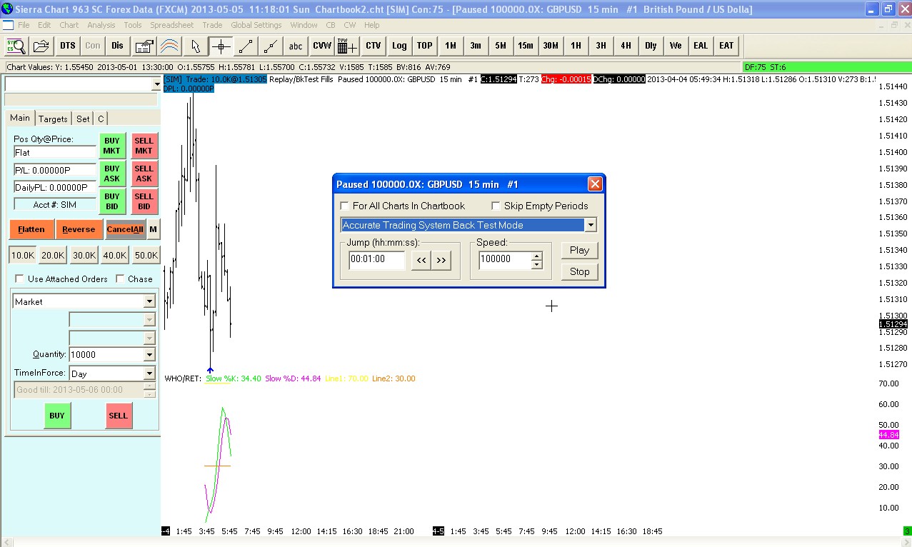

5. I clicked Auto trade system Replay/Backtest and clicked Yes
6. Sierra started a replay as seen in second attached pic

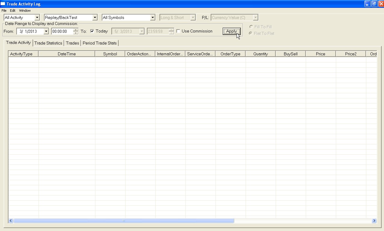

7. When it is finished, my Trade activity log looks empty as attached.
What did I miss please?

[2013-05-05 09:54:39]
The Stochastic Crossover System is not an automated trading study. It only gives a visual indication of trade signals.
You will not find any actual automated trading systems in Analysis >> Studies >> Studies Available. There are some examples in Analysis >> Studies >> Add Custom Study >> Sierra Chart Custom Studies . They begin with "Trading".
