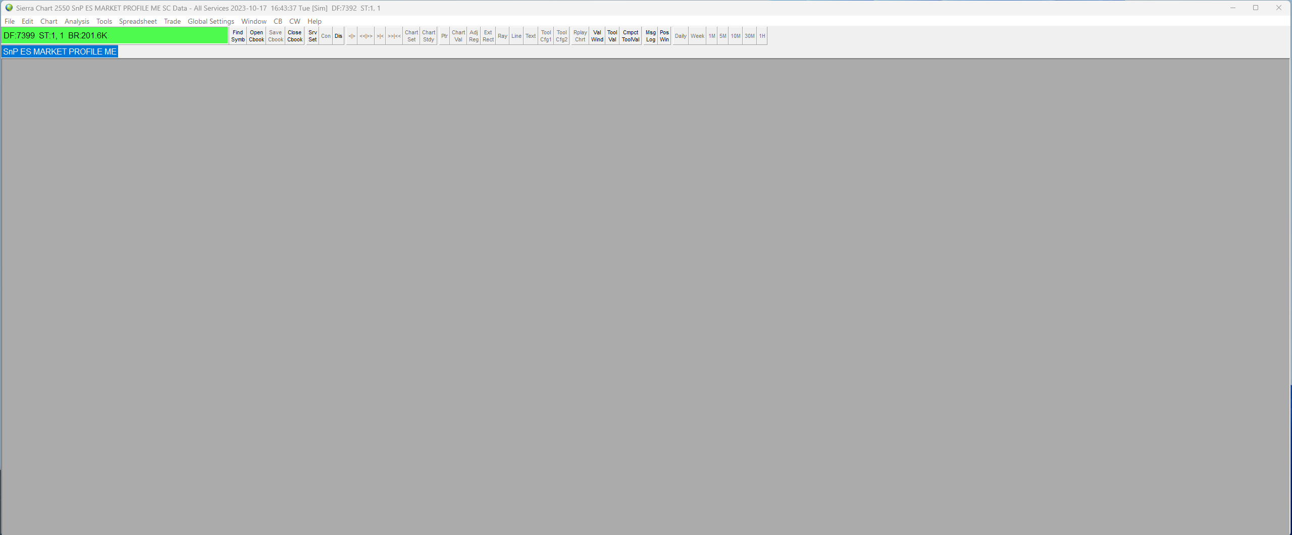

i've spent a lot of time today setting up a number of charts and to my dismay they have all disappeared...
the .cht files are present however the display of the chart is missing on the screen.
when i look in the <data> folder, it shows the file as 48 B which doesn't look right.
i've attached 2 files for reference. the first shows my chartbooks and the second shows my blank screen after selecting a chart
can someone please shed some light ASAP?
TIA
Date Time Of Last Edit: 2023-10-17 21:04:33
imageScreenshot 2023-10-17 164348.png / V - Attached On 2023-10-17 20:45:15 UTC - Size: 42.54 KB - 258 views
imageScreenshot 2023-10-17 164112.png / V - Attached On 2023-10-17 20:46:07 UTC - Size: 33.57 KB - 270 views

SafSaf - Posts: 160
hi john, it's worrying that you don't know what might have occurred. there is ample space on my drive. i've raised this issue now but it's not the first time it's happened to me. i'm worried moving forward it will continue to happen and a lot of time goes into setting up the charts to the way i want them.
after saving the charts i can access them but after a random amount of time (a few days maybe) the file sizes shrink to 4 B and the charts disappear.
my computer is brand new btw

SafSaf - Posts: 160
Thanks for all your help. I've now worked out what the issue was... just in case someone else comes across this same problem, let me elaborate;
When I finish with my chart, I go to file > save. Then I close the chart down by clicking the 'x' on the top right of the window.
However, the tab is still open at the top of the screen for the chartbook, so I go back to file > close chartbook. Another small screen asks me if I want to save again, and I've been saying yes, but there is no chart on the screen, so it's been saving it again with no chart... hence my charts disappearing!
Very annoying that it asks twice or doesn't close down.
