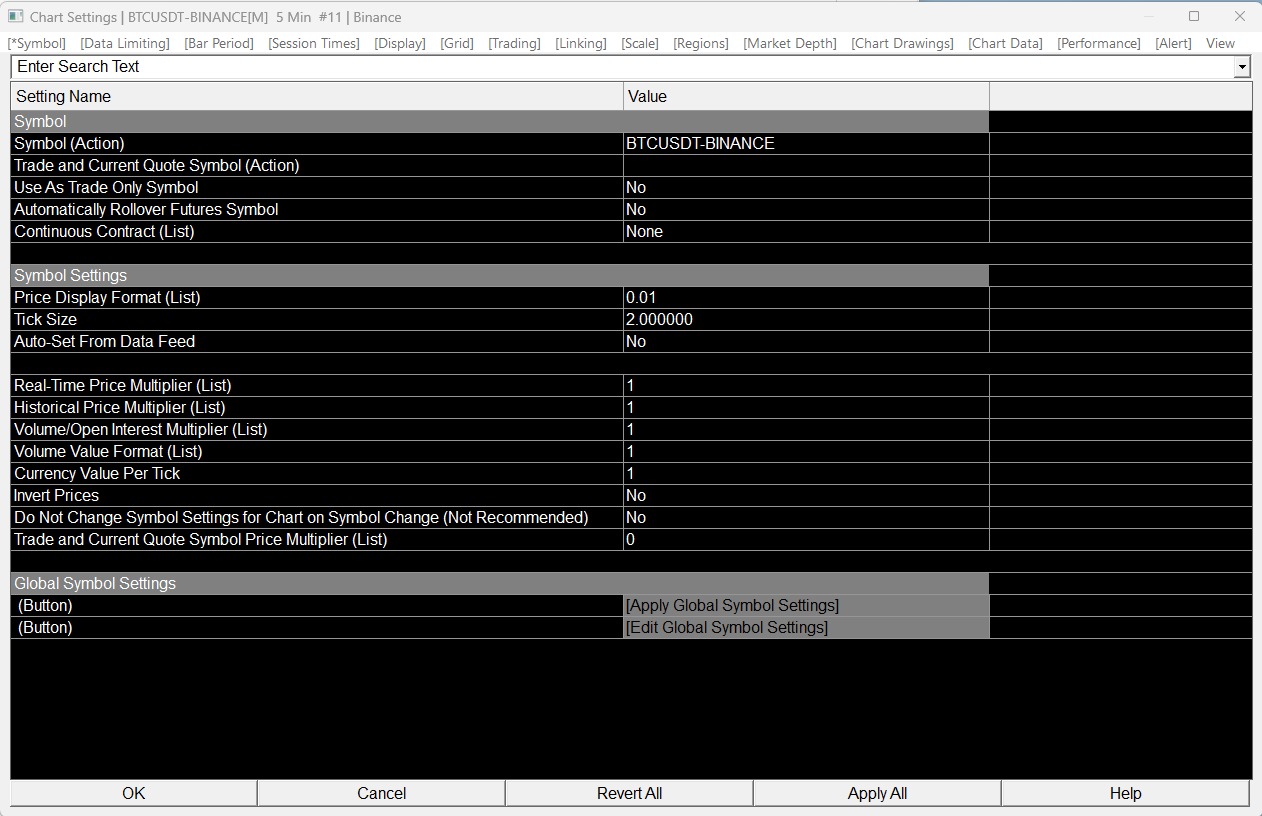

Sierra_Chart Engineering - Posts: 24908
For the Tick Size use:
2
You have it set too high.
This is the setting we are referring to:
Chart Settings: Tick Size (Chart >> Chart Settings >> Symbol >> Symbol Settings menu)

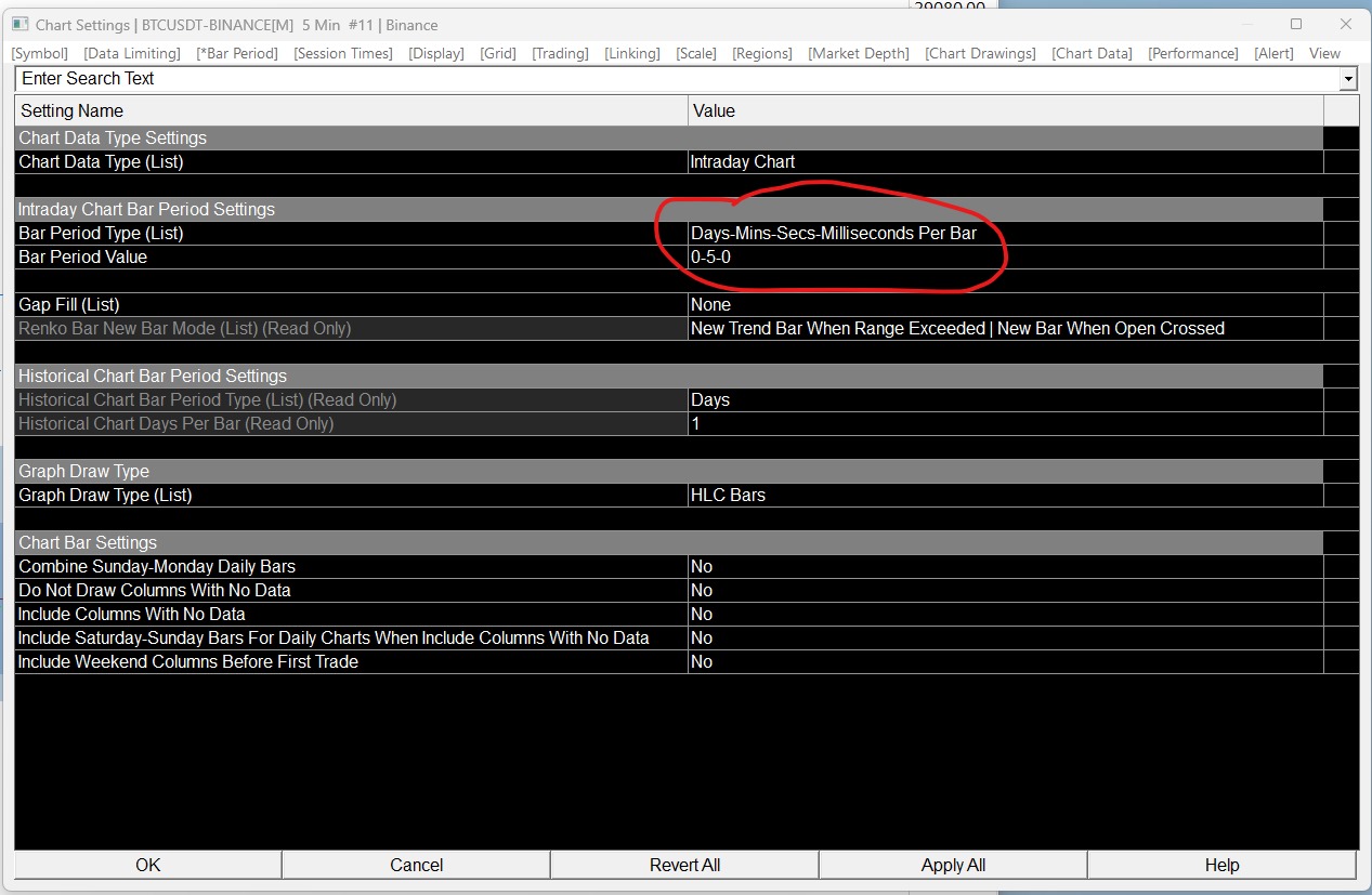

[2023-10-19 10:08:43]
SafSaf - Posts: 160
one more question oh wise ones...
please see the attached screen shot.
what values should be in these to columns please?
comparing it to my ES chart, which reads 'volume per bar' and '5000' respectively, it seems the set values for my bitcoin chart are too detailed. i'm presuming that's why my computer slows down??
anyhow, when i attempted to change the values in the bitcoin chart to 'volume per bar' and '5000', the chart starts to load up but stops at 99.23% every time. i end up having to abort.
i've also attached the values in the <symbols> part of the chart settings if you don't mind checking the values i've inputed there too?
