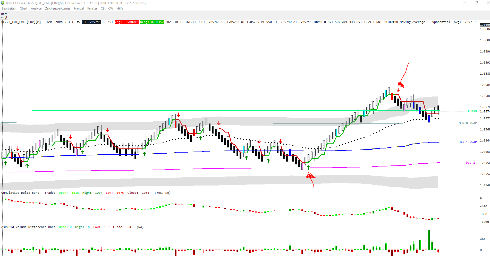

Hello, I would like to receive a notification on my PC when the VWAP Halftrend changes trend

[2023-10-16 19:06:21]
John - SC Support - Posts: 48459
Refer to the information for Alerts at the following link:
Study/Chart Alerts And Scanning
For this particular case, since you are already getting a visual cue, you can use that to generate the audio Alert. Basically, your alert condition would look something like:
=ID1.SG1
Where ID1 is the ID of the study that is generating the arrows, and SG1 is the Subgraph of that study that is actually drawing the arrows.

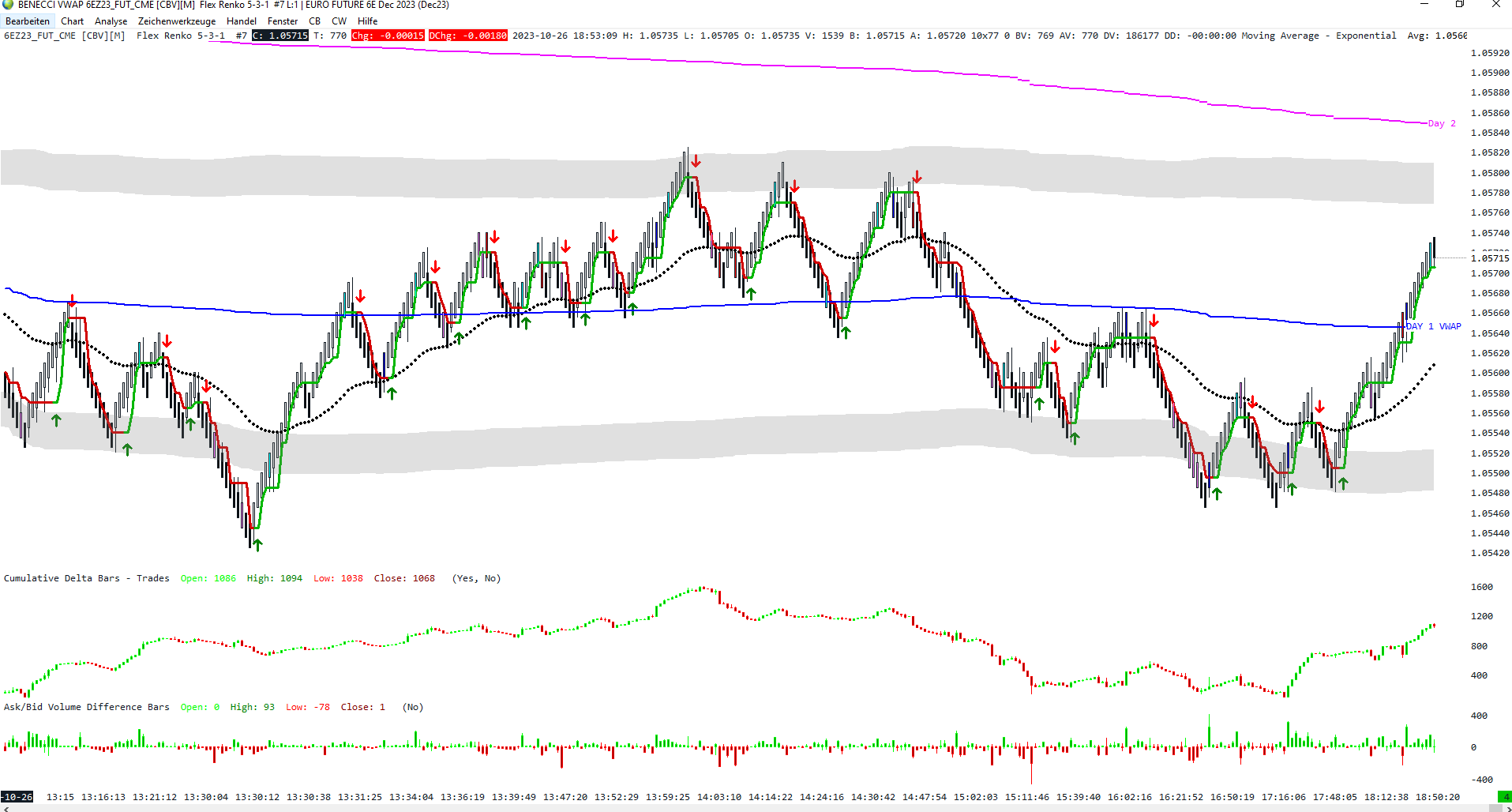

Sorry for the late reply, I would like to get a desktop notification when the halftrend changes trend as you can see in the picture shown with arrows.

[2023-10-26 19:22:01]
If you are using our built-in HalfTrend study, then the formula to be notified when either arrow is printed would be the following:
=OR(ID1.SG2, ID1.SG3)
Where ID1 is the ID of the HalfTrend study and SG2 and SG3 are the Arrow Up and Arrow Down subgraphs (respectively).
If you are using a different study - or one that is not from us, then you would have to reference the appropriate subgraph.
Refer to the information here:
Study/Chart Alerts And Scanning: To Enter an Alert Condition on a Study
Study/Chart Alerts And Scanning: Referencing Study Subgraphs
Study/Chart Alerts And Scanning: Referencing Other Studies on the Chart

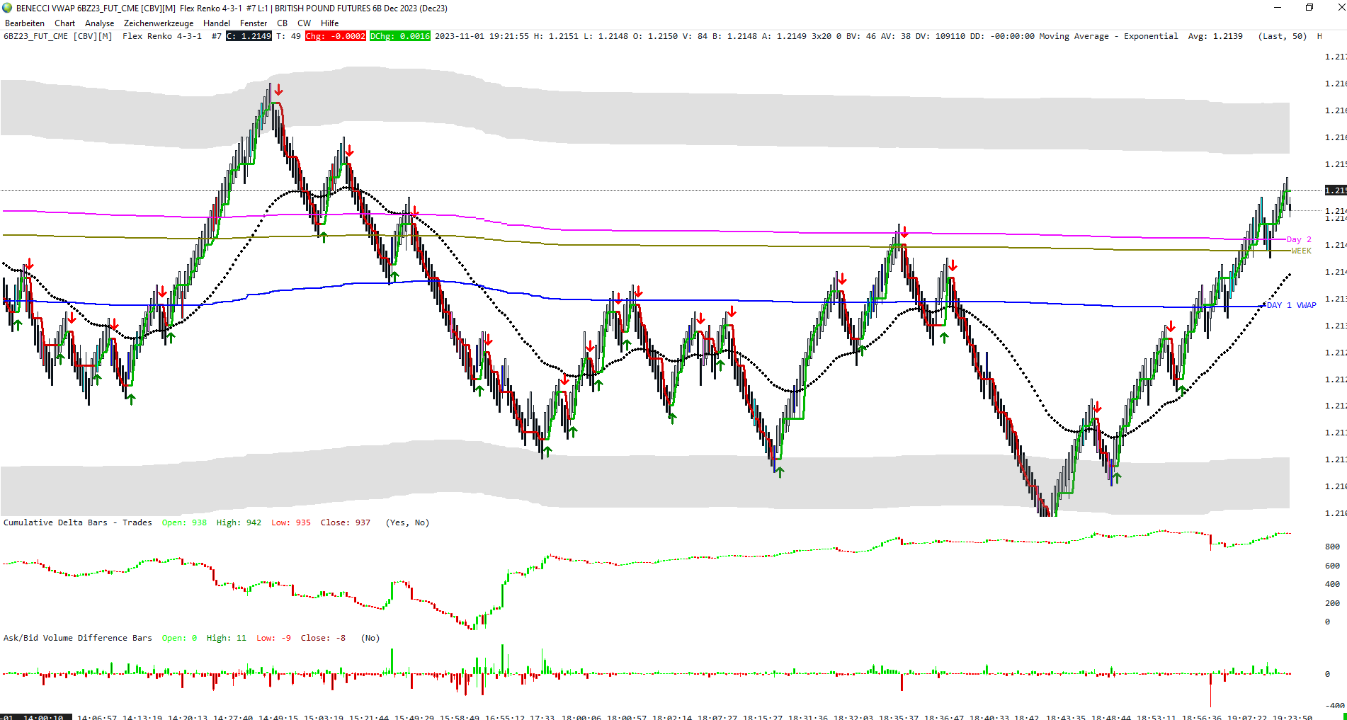

Hello, I would like to receive an alarm when the trend changes. In the appendix you can see in the picture that it is shown with arrows. I use half trend indicator for this.
How can I get a notification?

[2023-11-01 19:50:26]
We are not sure we understand what you are looking for in terms of when the "trend changes". By definition, the HalfTrend study changes between Arrow Up and Arrow Down. Therefore, the indication that a trend has changed is when an arrow is printed, which is the same as the alert we gave you previously.
