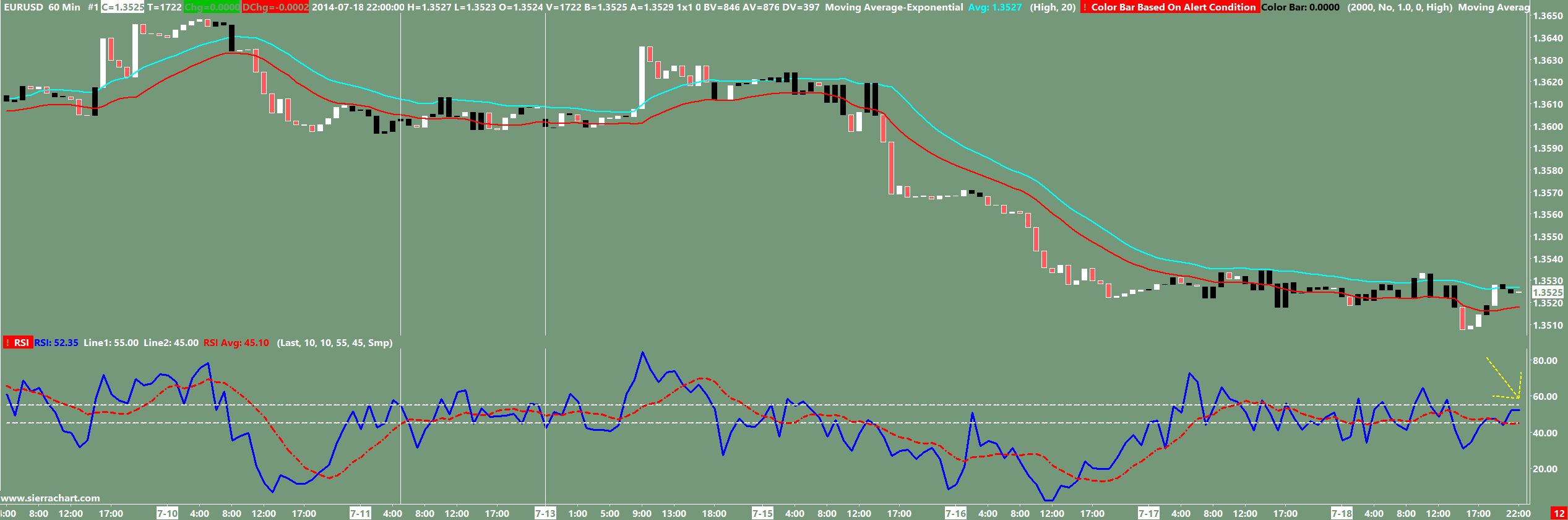

jaban - Posts: 66
http://www.sierrachart.com/image.php?l=1405889906308.png
Hi the last Bar from Friday showed an alert buy , but the buy
was not there yet
I added the ( black ) color bar based on the same alert formula
thanks
jaban
[2014-07-20 21:08:27]
Please draw an arrow or something else on the chart pointing out the signal that you think is not right. And post the image again.
You can use the Tools >> Arrow tool.

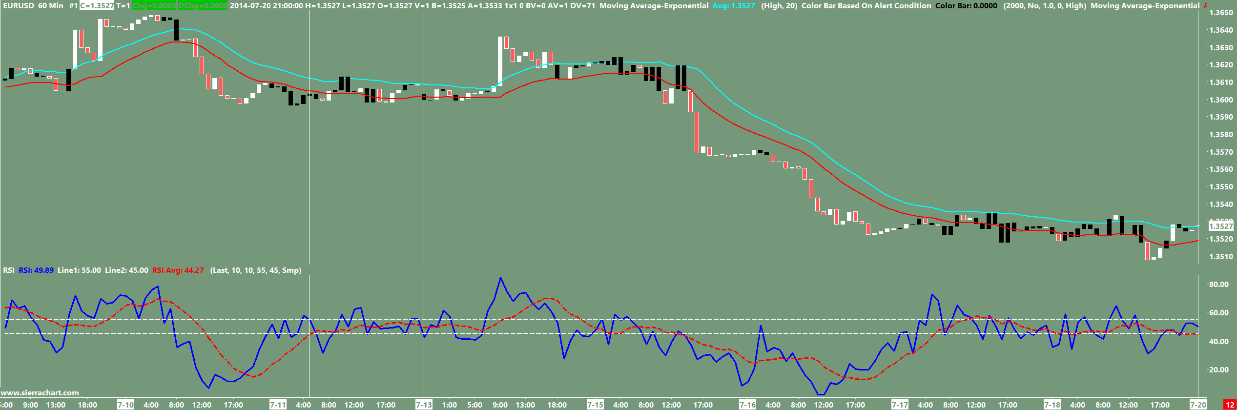

jaban - Posts: 66
http://www.sierrachart.com/image.php?l=1405890741277.png
[2014-07-20 21:29:40]
At the very last bar in the chart, the bar is not black so it is not colored by the Color Bar study, so we are not really understanding the problem.
[2014-07-20 21:54:21]
jaban - Posts: 66
Hi
The problom is :
The alert manager showed an alert on the last Bar Friday ,
where the RSI was not above the 55 line , ( see arrow ) ,so there should
not have been an alert.
And this happened on a number of charts.
jaban
[2014-07-21 01:26:18]
At this point, it is impossible for us to give an answer as to why that happened. The most reasonable explanation is as the bar was forming, the Alert Condition Formula was momentarily TRUE.
