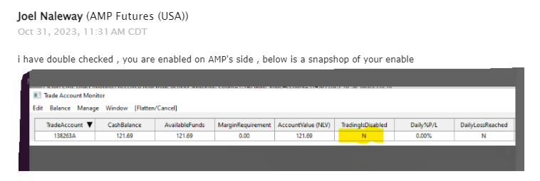

here is from AMP - they seem to disagree -please can you rectify this? see attached
imageAMP data feed confirms.png / V - Attached On 2023-10-31 16:43:19 UTC - Size: 42.69 KB - 183 views
[2023-10-31 18:31:02]
You have the wrong account selected. The account number in the Trade Service Log is "138263", but AMP shows your account as "138263A" (as you also mentioned above).
