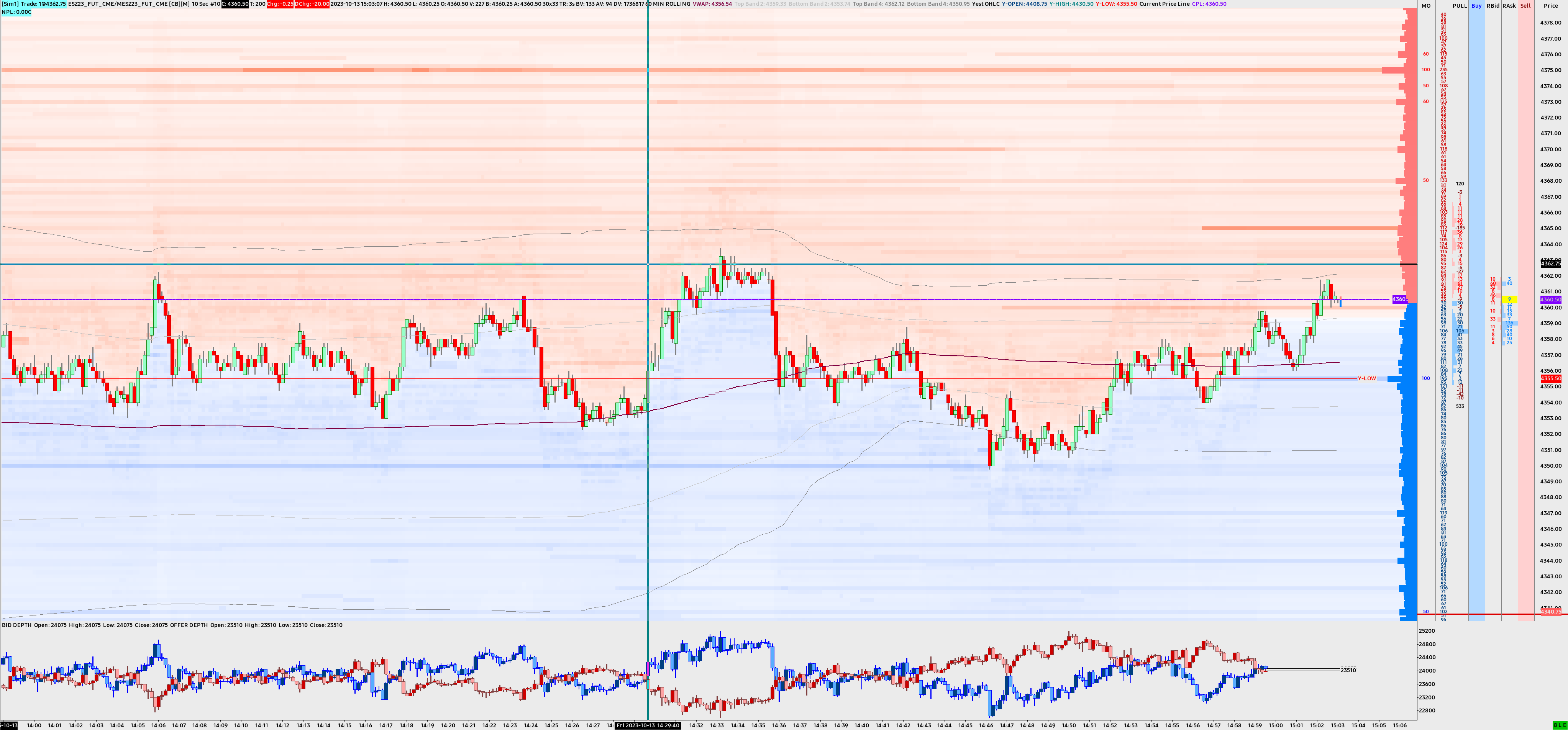

See pic. Not happens on previous version
imageScreen Shot 10-13-2023 at 11.29 AM.png / V - Attached On 2023-10-13 18:36:30 UTC - Size: 32.13 KB - 259 views

Please give us a screenshot by following these instructions:
We need to be able to see the entire chart as it gives us a lot of additional information. Also, what is the symbol for this chart?
[2023-10-13 19:05:23]
Tooth Fairy - Posts: 89
Here u go.
The symbol is ESZ23
https://www.sierrachart.com/image.php?Image=1697223789167.png

And for the record, this issue that you are having has been extensively looked at, before we posted. There is not any problem. Your chart displays just fine:
https://www.sierrachart.com/image.php?Image=1697323927452.png
We did observe an issue, as we said where the downloading of historical market depth data does not occur, under a certain condition, until trading begins. So maybe there is a scenario going on in your case where missing historical depth data did not get downloaded which the study depends upon.
Date Time Of Last Edit: 2023-10-14 22:53:04
[2023-10-14 23:46:41]
This is strictly an issue involving historical market depth data:
It is not related to the Bid and Ask Depth Bars study.
If you look at that image closely you can see the historical depth data, stops at the exact location as the bid and ask depth bars study is no longer showing any new result.
