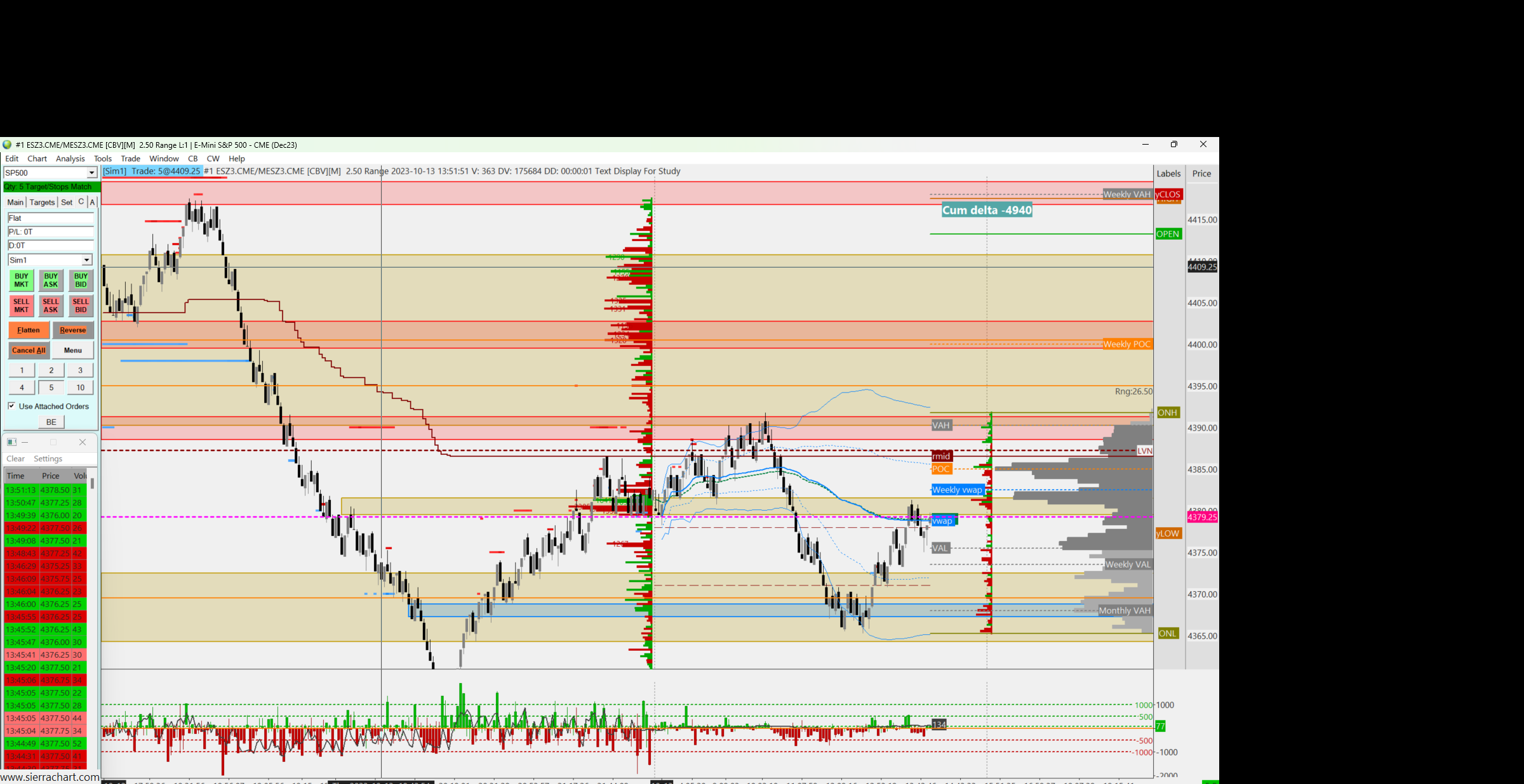

I have a delta profile, and I show volume numbers > 1000 and I do not fix them to the base of the bars. But they are displayed somewhere in the middle of the bar!? See attached screenshot, the profile in the middle of the screen. Any ideas of what's going on? :)

When the numbers are not fixed to the "Base" of the bars, then they are drawn at the end of each bar, which is what you are seeing. They are hard for you to read since they are the same colors as the bars, and the bars are relatively small to begin with. But what you are seeing is correct for how you have it setup.

I don't think that is the case, see attached screenshots.
On the first screenshot, you can clearly read "1005" down to the right (zoom in).
https://www.sierrachart.com/image.php?Image=1697214727266.png

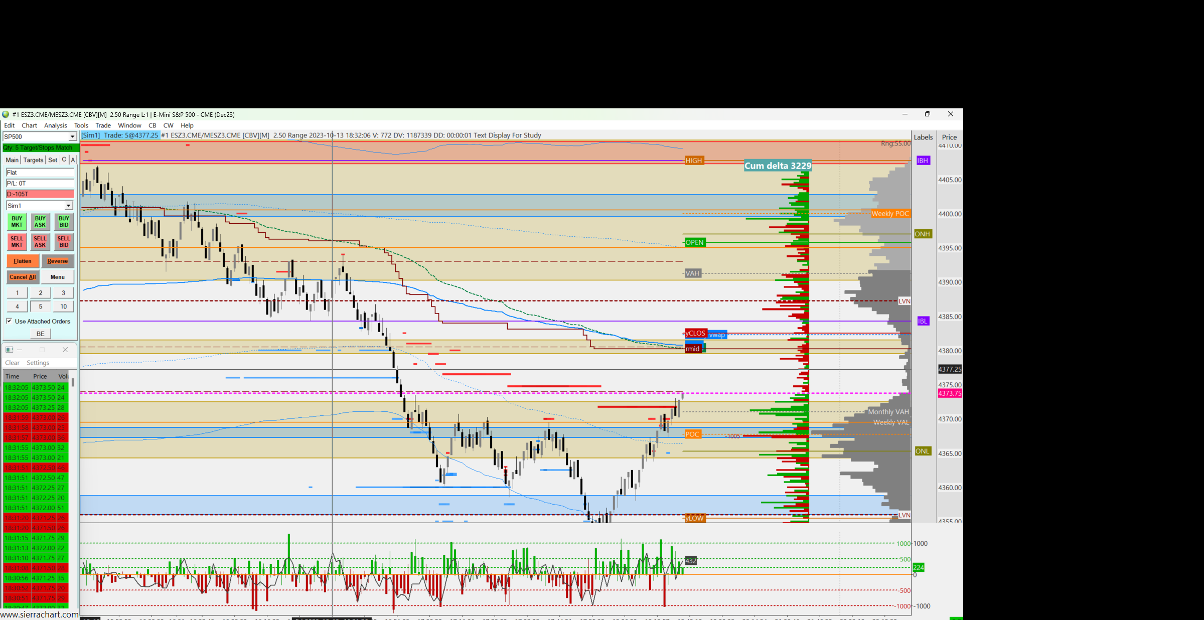

I then moved the chart to the right, so the previous sessions profile came into view (on the left side).
The "1005" is then overlapped by the red bar.
https://www.sierrachart.com/image.php?Image=1697214763475.png
The only thing i did was to move the chart.
/Anders
[2023-10-13 16:41:13]
Your second image is the "correct" one. We have no idea why the number is not being overlapped in the first image.
This is not something that we can easily reproduce - unless you can always reproduce this with your chart. In which case, please get us that chart and we will see if we can see the same thing and figure out why the number is on top of, instead of under, the bar. Refer to the following instructions for how to get us a chart:
