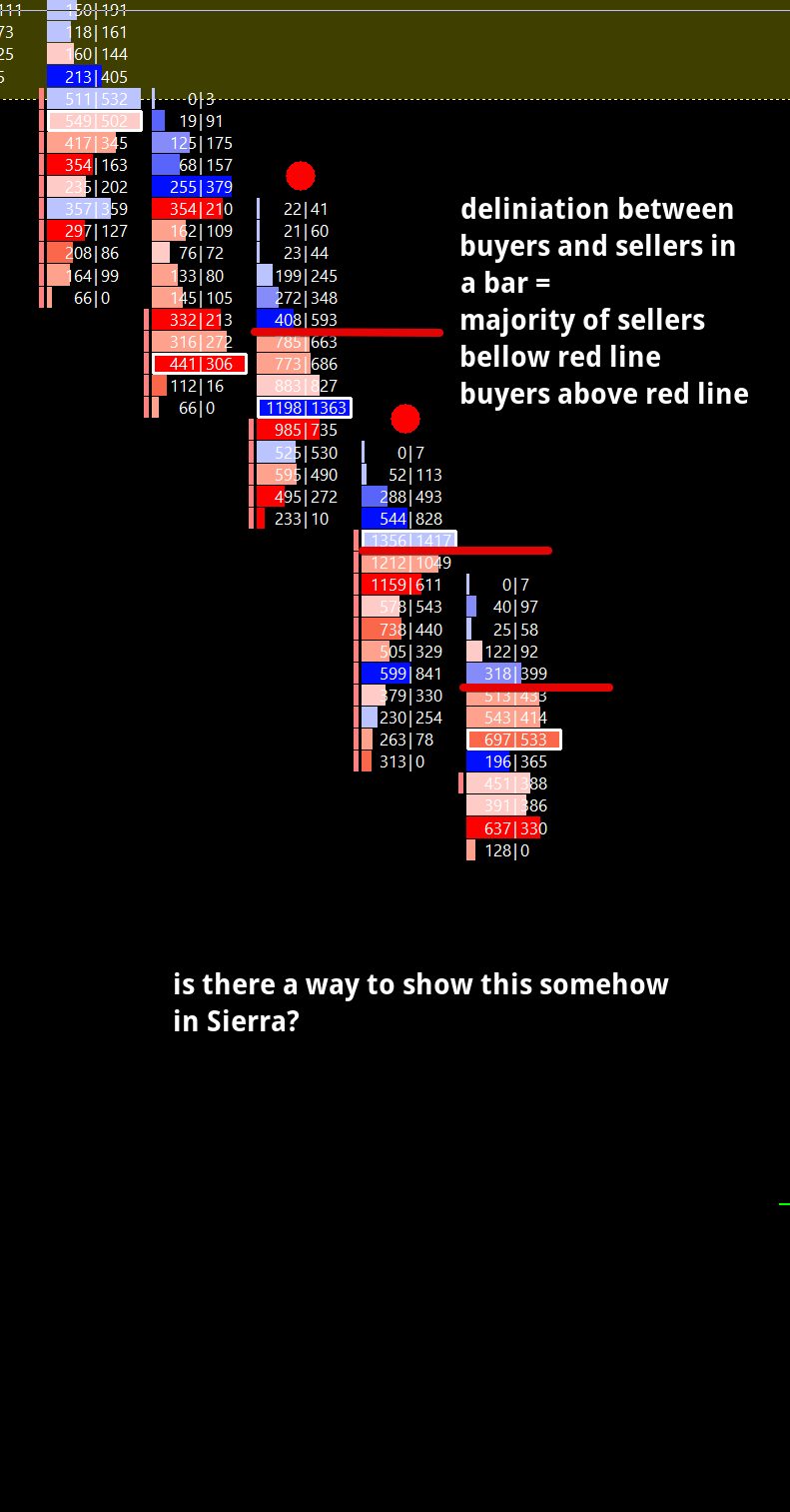

Is it possible to show the price point in a bar, where sellers and buyers delineate.
Hence where there is a clear difference of activity where buyers or sellers changed the flow in order flow.
I can see this visually as marked in pic attached however would like to have these area's shown automated by Sierra if possible.
PS>> This is not the point of control.
How can this be achieved?
Many thanks
imageBuyers vs Sellers Deliniation in a Bar.png / V - Attached On 2023-10-12 13:41:56 UTC - Size: 78.68 KB - 204 views

Unfortunately, working with the Bid/Ask data is not easy with the built-in tools in Sierra Chart. The easiest solution would be to create a Custom Study to do this - or to hire a programmer if you do not have the programming abilities. Refer to the following:
How to Build an Advanced Custom Study from Source Code
List of Third Party Sierra Chart Study and System Programmers
Apart from the above, the one thing you would want to look into is the Spreadsheet Formula, which uses the Alert Syntax, along with the ability to get the Ask/Bid information at each price level. You might be able to put together a way to do what you want using these pieces. Refer to the following:
Spreadsheet Formula
Study/Chart Alerts And Scanning: Special Functions
