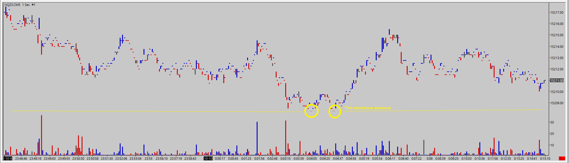

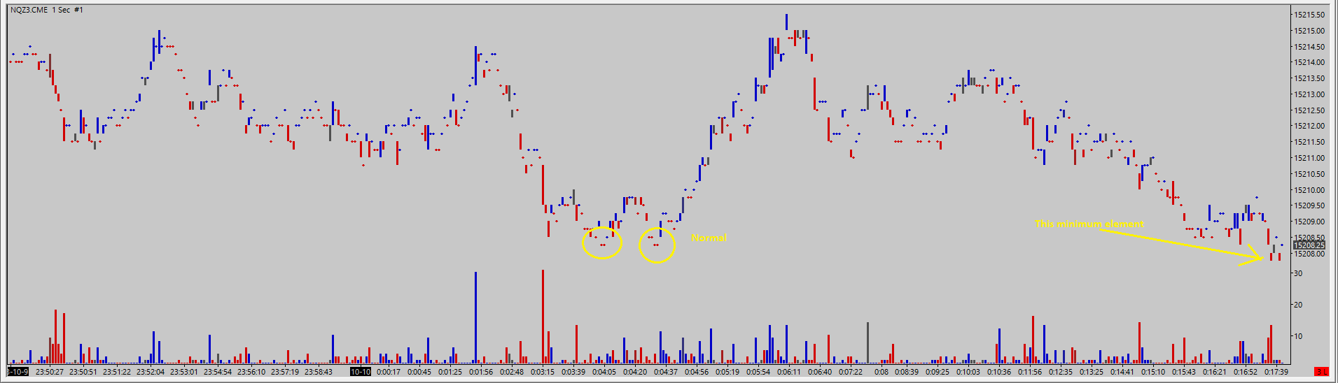

This happens if it is the lowest on the chart. How do I make sure that the element is always displayed in full?

The problem of partial display of elements occurs if High=Low=Close
This problem also exists at the top of the chart

Yes, this happens with the DRAWSTYLE_DIAMOND or DRAWSTYLE_POINT element. If it is at the top or bottom of the edge of the graph, then its display is halved. I move the graph in Tools->Hand mode, or it moves realtime. And it turns out that if the bar is a point (High=Low=Close), then DRAWSTYLE_DIAMOND or DRAWSTYLE_POINT is not displayed completely, this greatly affects the perception of the chart and trading with the eyes. At the same time, you have to compress the chart vertically so that all the bars are fully displayed, which is not convenient.

When we move the graph horizontally, the vertical part automatically adjusts and we see the entire graph vertically. If there are a lot of prices, then the bars are vertically compressed and vertically we should see all the bars completely. This is how sierrachart behaves in a standard way. But if the price bar is a dot, then it is not completely displayed at the edge of the screen, but if High <> Low, then it is displayed correctly and there is no cropping. Why is the point being cropped? I can throw off the indicator completely, but not to the public

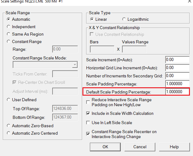

What is the "Scale Padding Percentage" set to for that chart? Refer to the following:
Chart Scale and Scale Adjusting: Scale Padding Percentage (Scale Settings)

SkyKeeper - Posts: 40
Great! The problem has been solved, see screenshots
Thank you for your help!
