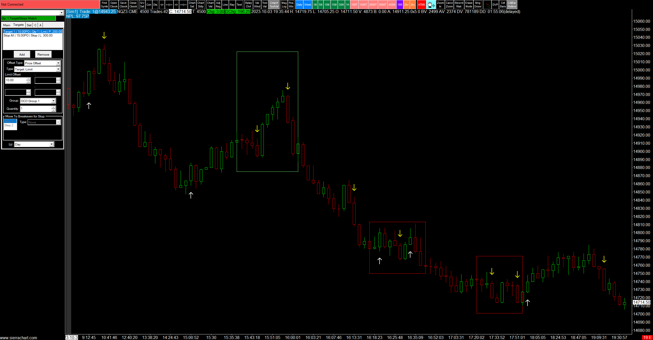

Hi Sawtooth, you're a genuis! your suggestion works perfectly. I just need to find a way to get rid of the fake signals at the bottom right of the graph without entering late on the first Signals (left hand side). The problem with adding too many filters to remove the noise is you enter late on the good trades.
Thank you very much!
https://www.sierrachart.com/image.php?Image=1696456570550.png
