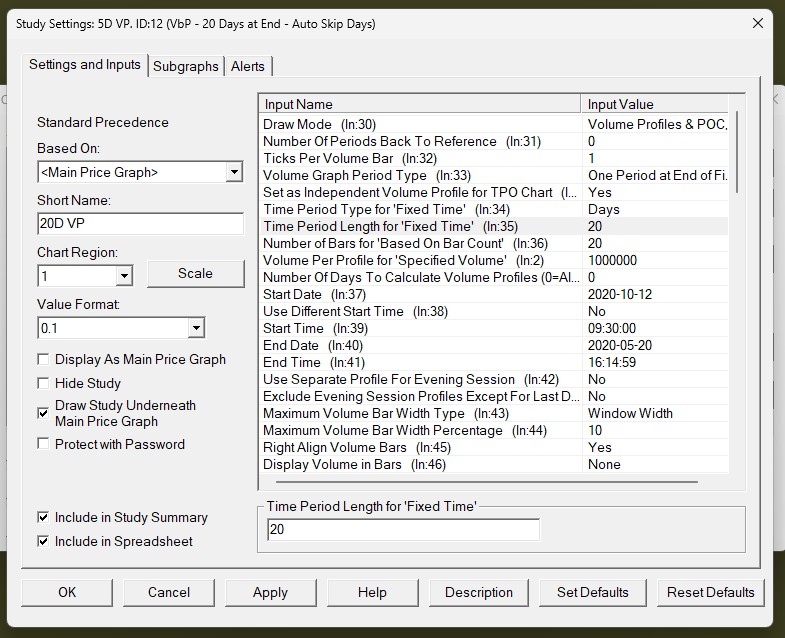

The solution to this is to set an Intraday chart to 1 Day Per Bar and to have the Volume Graph Period Type with the Volume by Price study using one of the "Bar Count" settings which would need to be set to 20.

I am confused...is this correct?

Actually thinking about it, yes that would be the correct option. We were not thinking of that but that is the right way to do this.
Here is the relevant information:
Volume By Price Study: One Period at End of Fixed Time Length - Auto-Skip Empty Days

Set your "Volume Graph Period Type" to "One Period At End of Fixed Time Length - Auto Skip Empty Days". Then set the time period to 20 days. This will give you a 20 trading day volume profile.

coachted - Posts: 544
thats exactly what i have yet i does not match an outside source i use or if i merge 20 full session volume profiles together

We are seeing a correct result, with the volume profile starting today at September 7 18:00 US Eastern time. And the trading day date for that is the following day. So if you count the days it is exactly 20.
Still, we want to look at the calculations and verify how all of this works to make sure it will be correct under all conditions. But it may not work perfectly under all conditions. There is another alternative and we will explain that later today.
