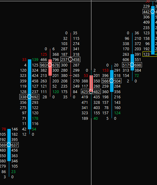

I'm having trouble centering elements of my footprint chart. In the image you can see that the wick and body of the candles seem to be centered with my crosshair but the number bars and the point of control circle are off center a pixel or 2. Is there a way to center everything in column?

[2023-09-27 15:37:30]
John - SC Support - Posts: 48493
What study, draw style and width are you using to display the Point of Control?
[2023-09-27 15:56:04]
Hofmeister - Posts: 27
The Study is called "Volume Point of Control for Bars." I was point to use that because I didn't like how the numbers bars study boxed in the POC as it made it difficult to read number more than 1000 on the Bid side.
[2023-09-27 16:06:12]
What is the Draw Style of the Subgraph for the "Volume Point of Control for Bars" study and what is the Width/Size of that subgraph?
[2023-09-28 13:13:35]
I switched the drawstyle to point with a size of 4 and I still have the same issue. It doesn't matter what size or drawstyle I chose. You can see it with things like the diamond and star too. If you look really closely, you'll notice the bid and ask columns are perfectly centered either. The ask column is slightly closer to the candles.
[2023-09-28 14:11:23]
We appreciate that you are looking at the information so closely, but in the end this is not something we can change any time soon. How these drawings is done is at a fairly low level and would take some time to deal with.
