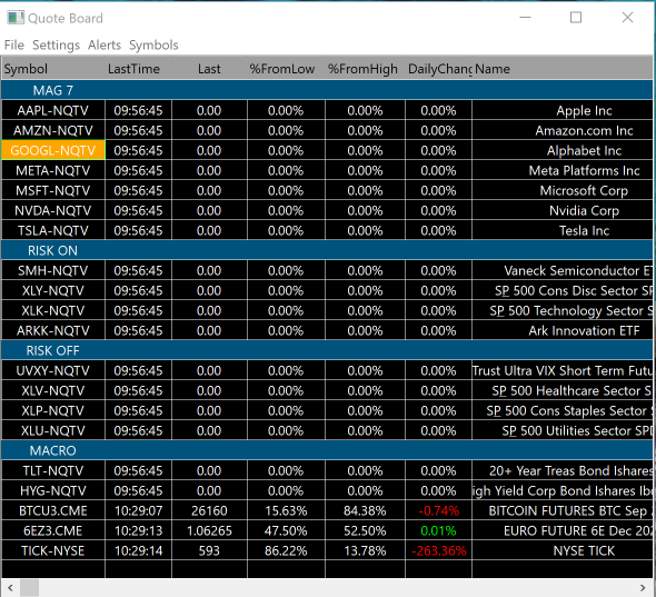

I have a quoteboard and charts containing several symbols listed on NQTV including AAPL, GOOGL etc.
for some reason the quoteboard does not update at all and the charts only update when I press the INS key.
I have only delayed feed right now as I have not upgraded to realtime, however, I have signed all of the Nasdaq agreements.

It does not matter that you have the agreements signed, until you activate and pay for the exchange, you will still only have the delayed streaming data. And in this particular case (the Nasdaq TotalView Data) the Quote Board does not update with the information.
You need to use the standard symbol, which will get you the delayed streaming data from our U.S. Equities Consolidated Tape exchange. So enter "AAPL" instead of "AAPL-NQTV". Your quote board will update in this case, just keep in mind it is still delayed data.

User244723 - Posts: 8
The only AAPL I have available to me is AAPL-NQTV. AAPL does nothing.
I should probably add that I am using Rithmic as my trade and data service (APEX)
This previously worked fine until a few days ago.

If you are connected to Rithmic, then you should never have been able to get any data for U.S. Equities, regardless of whether it was with the -NQTV suffix or not.
If it was working a few days ago, then our best guess is that your "Current Selected Service" at that time was set to "SC Data - All Services" or one of the "Trading Evaluator" options. Since those are related to us (Sierra Chart) you would be able to get the Delayed Streaming Data for the U.S. Equities (along with EUREX - you are setup to get real-time data for us for the CME Group and CFE).
Our recommendation is to install a second Sierra Chart that has the "Current Selected Service" set to "SC Data - All Services". This way you can view the delayed U.S. Equities data in that version - and you can use the standard symbols - you do not need the -NQTV. Refer to the following instructions to install a second Sierra Chart:

You should be able to get delayed NASDAQ TotalView data, even when connected with Rithmic. We have to look into this.
[2023-09-26 23:05:31]
The issue you had with delayed TotalView data is now resolved.
Restart Sierra Chart.
