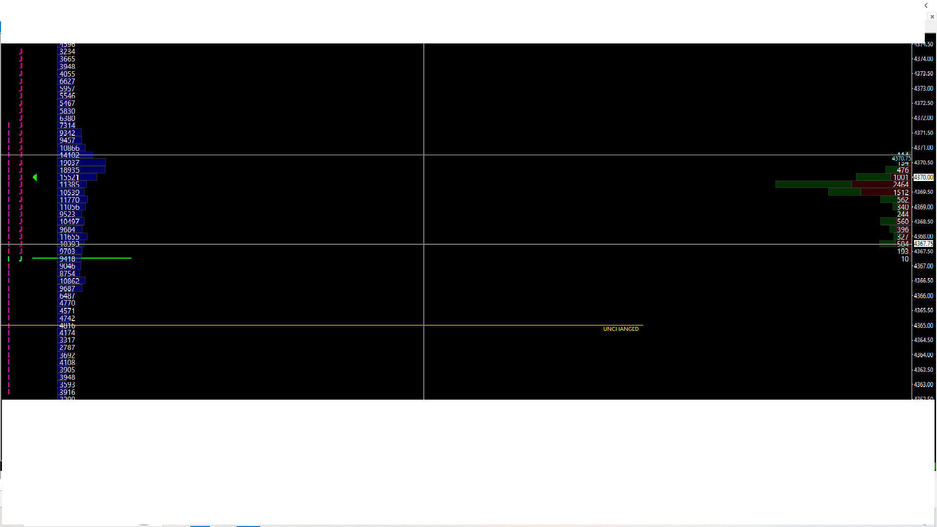

Hi I was wondering if its possible to have a VBP that "resets" every 30 min (every period of the TPO) I tried to follow a guide on the site and It's not working.
I attached 2 images to try to explain better what I mean by "It's not working".
Image 1. right now the VBP on the right is not showing the volume where J period passed, to be precise it's not showing the volume above 4370.75.

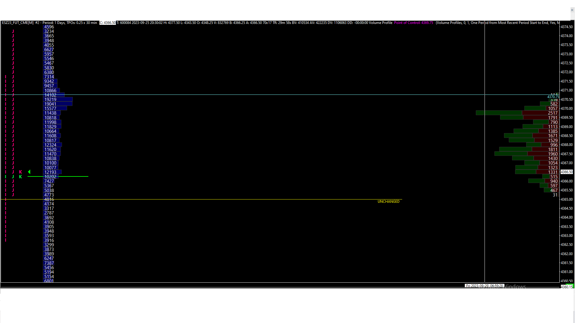

Image 2. now the k period just started and it's still showing a VBP using the J period's volume
So my final question is: Is it possible to set up a VBP that, in this case when the K period starts, it resets? if Yes how?

There is not an easy way to do this. You would have to use the Volume Graph Period Type of "From Start Date-Time to End Date-Time" and define the Date and Times for the 30 minute period. Refer to the following:
Volume By Price Study: From Start Date-Time To End Date-Time
