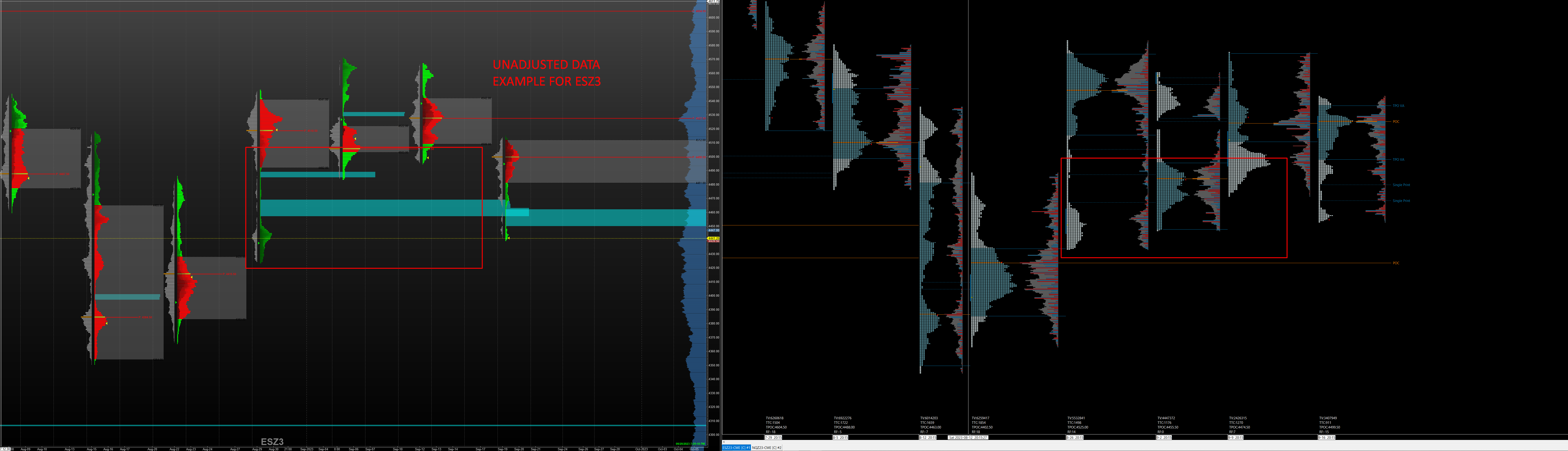

I have previously searched this in the forum but the answer given was to read a link, which I did and still don't think I am doing this correctly. I have unadjusted data on another platform to compare to so I must of done something wrong here. See attached pictures below. I tried using "continuous futures contract - Date rule rollover which worked for my NQ chart but the ES one here does not match the unadjusted chart on the left.
imageUnadjusted data.png / V - Attached On 2023-09-21 00:31:43 UTC - Size: 386.84 KB - 217 views

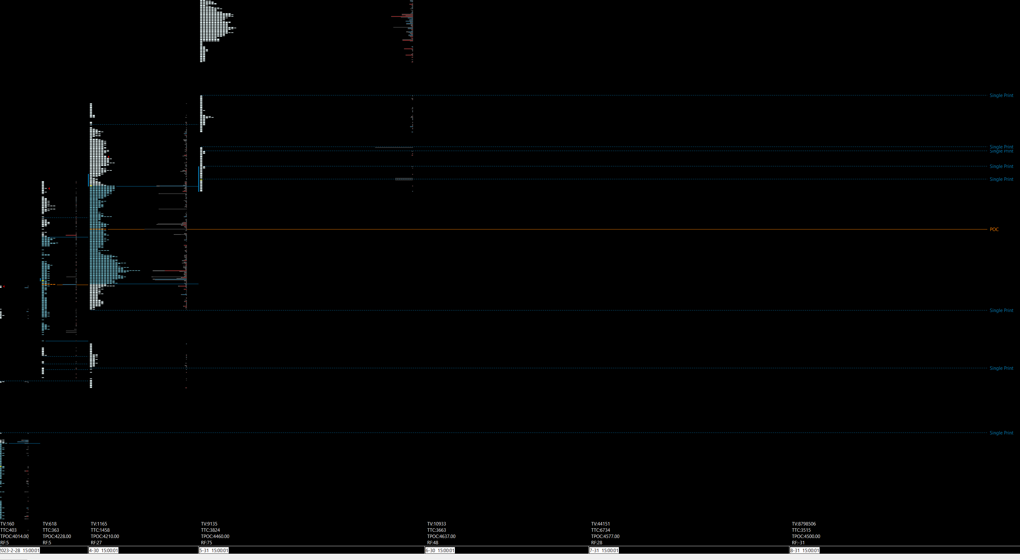

On a side note I created a monthly TPO/VP chart and have this going on. I have days to load set at 600 so not sure what's causing that.
Date Time Of Last Edit: 2023-09-21 00:44:24
imageMonthly VP messed.png / V - Attached On 2023-09-21 00:44:20 UTC - Size: 54.23 KB - 250 views
[2023-09-21 13:33:14]
caligola - Posts: 116
check if in Global Settings >> Symbol Settings ES and NQ have the same Rollover Method.
you can also click on Open Rollover Settings to check if the rollover date is the same as the CME one https://www.cmegroup.com/trading/equity-index/rolldates.html
[2023-09-21 14:18:03]
Jaydtrade - Posts: 125
Yeah they are the same Rollover method. Which option is the unadjusted data method
[2023-09-21 14:40:24]
Any of the Continuous Futures Contract options that are not "Back Adjusted" are "Unadjusted".

Okay and what about this other issue I am having please.
"On a side note I created a monthly TPO/VP chart and have this going on. I have days to load set at 600 so not sure what's causing that."
[2023-09-21 16:09:53]
What is the symbol of that chart? Is it setup to be a Continuous Futures Contract?
If you remove the TPO and VbP, does the underlying data look correct?
