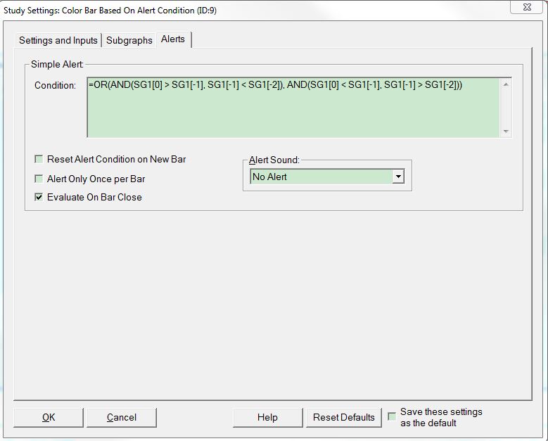

I try to do it myself. I use Color Bar Based On Alert Condition study, And do the setting as attached 2 screenshot. But the Hull mA in my chart still not change any color, always the green, not change color based on the slope. Could you help me to check what makes me wrong?
imageCapture-1.JPG / V - Attached On 2014-07-16 07:10:03 UTC - Size: 84.35 KB - 729 views
imageCapture-2.JPG / V - Attached On 2014-07-16 07:10:19 UTC - Size: 56.3 KB - 627 views
[2014-07-16 07:32:36]
In the Study Settings, set the Subgraph >>Draw Style to Line-Skip Zeros.
Date Time Of Last Edit: 2014-07-16 07:32:45
