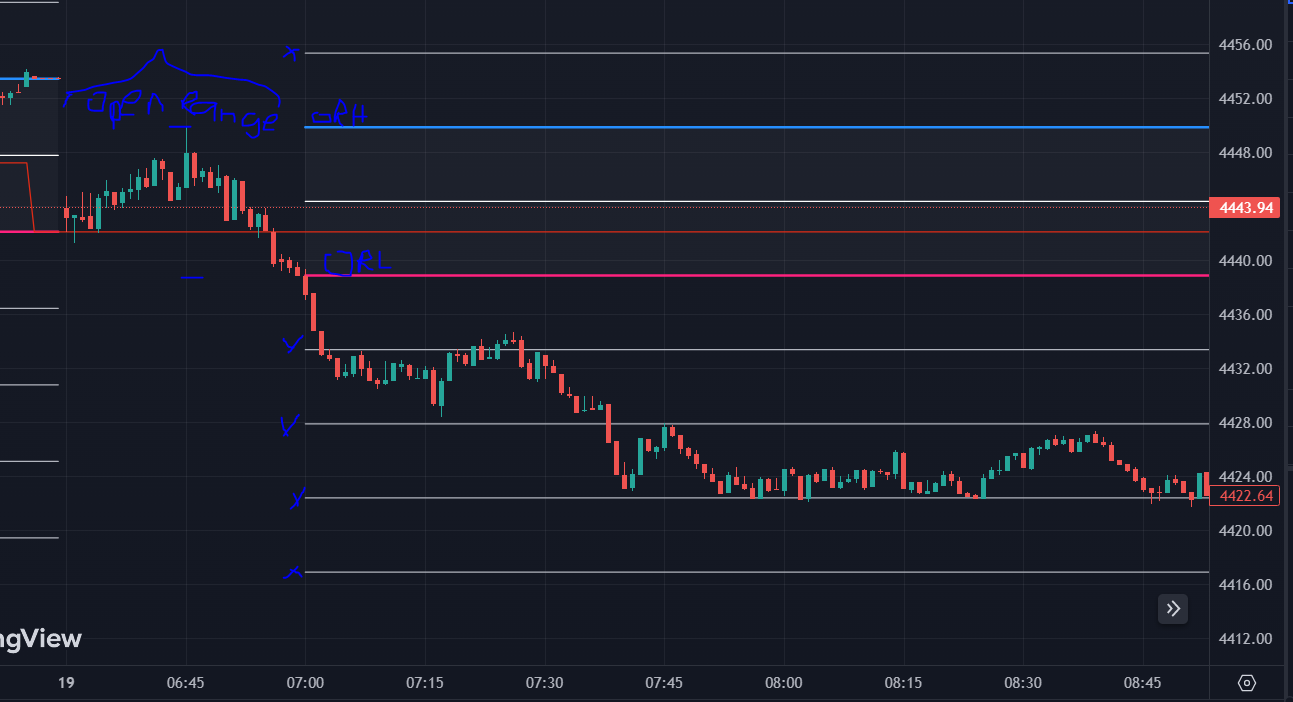

Thanks for the response John. I'm good with the opening range already using the high/low study and set the time for the first 30 min. This is on a 1 minute chart but that's not really important. It's the extensions I'm trying to enter. Again, I want to have multiple extensions up and down that are my opening range high minus opening range low/2. So as my previous example was 4300 ORH & 4270 ORL, I want to plot horizontal lines at (4300-4270/2=15) 4315,4330,4345 and 4255, 4240 and 4225. In your example I do not know how to apply bc you reference a specific number but the extensions will be different every day.
I attached a screenshot of what I used to use. Thank you so much.

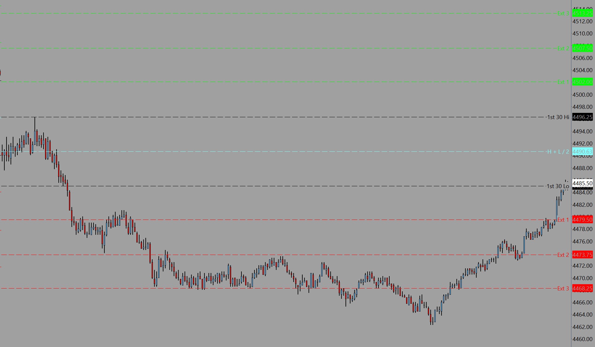

I could be misunderstanding exactly what you mean but, why wouldn't you just use the extensions built into the Initial Balance study?
Pretty sure they do exactly what you're looking for. Just use a 30 minute range instead of 60.
H - L/2 is simply the midpoint of the range.
You would then just use that mid for your extension levels - which are already there by default.
.5, 1, 1.5 above and below.
You'll also need to round to tick size and the study does it for you automatically.
Pic attached from today's ES of what it looks like and the chartbook.
Date Time Of Last Edit: 2023-09-20 01:53:46
imageOpen Range Extension.jpg / V - Attached On 2023-09-20 01:40:32 UTC - Size: 176.36 KB - 420 views
