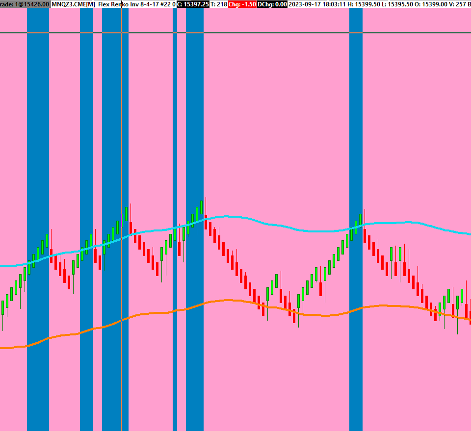

I need assistance with an alert formula to color blue the background when the close is above the upper band and have the background remain the blue color until there is a close under the lower band.
The background color will switch to a different color.
The attached screenshot of the chart with what I have so far and the alert code is below.
Upper Band: id6.sg1
Lower Band: id7.sg1
Blue color:
Or(C > id6.sg1, C > id7.sg1 )
Pink color:
Or(C < id6.sg1, C< id7.sg1)
Date Time Of Last Edit: 2023-09-17 22:08:50
imageColor background1.PNG / V - Attached On 2023-09-17 22:05:03 UTC - Size: 51.61 KB - 247 views
You need to create a persistent TRUE when the Close is > than the upper band, then release it when the Close is < the lower band.
Reverse the operators for the opposite color.
The TRUE, and the FALSE, are made persistent by referencing the color background's previous bar in the final 'else'.
Blue:
=IF(C>ID6.SG1,1,IF(C<ID7.SG1,0,ID8.SG1[-1]))
where this color background study is ID8.
Pink:
=IF(C<ID7.SG1,1,IF(C>ID6.SG1,0,ID9.SG1[-1]))
where this color background study is ID9.
