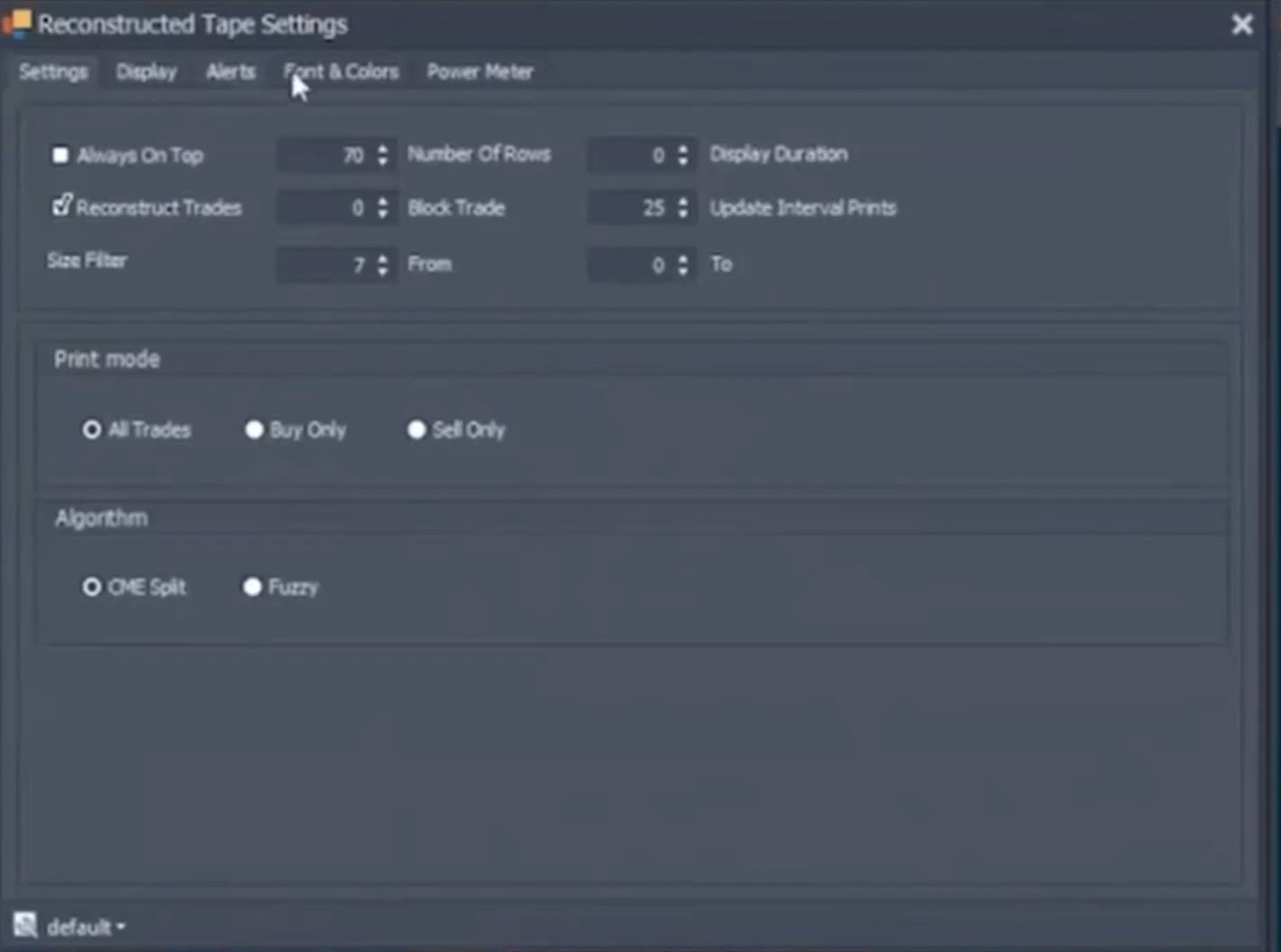

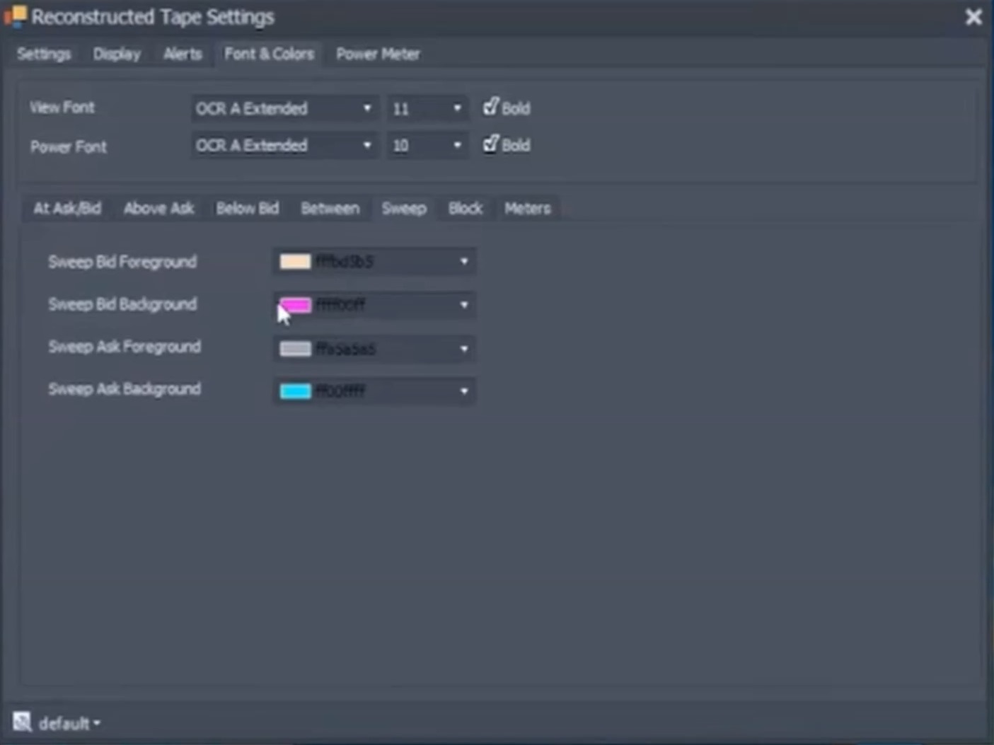

Hello, I wanted to make a tape with sweep settings, like I use on jigsaw. I'd love to have the same possibility on Sierra Chart. I sent you attached a screenshot of my jigsaw. I wanna see uptick for a buy or downtick for a sell.
And any possibility to reconstruct block trade ?
Thanks in advance, Julien
imageSCREEN SWEEP.jpg / V - Attached On 2023-09-20 09:56:33 UTC - Size: 75.3 KB - 615 views
imageBLOCK TRADE.jpg / V - Attached On 2023-09-20 09:57:45 UTC - Size: 80.91 KB - 488 views
[2023-09-20 15:52:44]
John - SC Support - Posts: 48028
We do not have anything built into the system to recognize Sweep trades.
As to the Reconstruct Block Trade, we know nothing about how Jigsaw does it. All we can do is point you to our options for Combining Records in the Time and Sales window, which are defined starting at the following link:

I answer your question about the fact that you do not know how Jigsaw offers sweep trades. I took stock with a trader friend who has Jigsaw on the UB
A sweep trade is a market order that consumes the entirety of one or more limit orders. In my example, it would be a market order greater than 24 to consume at least one line of the bid limit order.
To differentiate yourself a little more from jigsaw, you could add the options to know if it is one line or several limit order lines which has been consumed for market orders...
What you suggest to replace this reading is complicated to read and put in place, in the attachment I remind you of what a sweep trade is which is not complicated in itself:
Couldn't you offer this option like Jigsaw? I think this could interest a lot of traders
