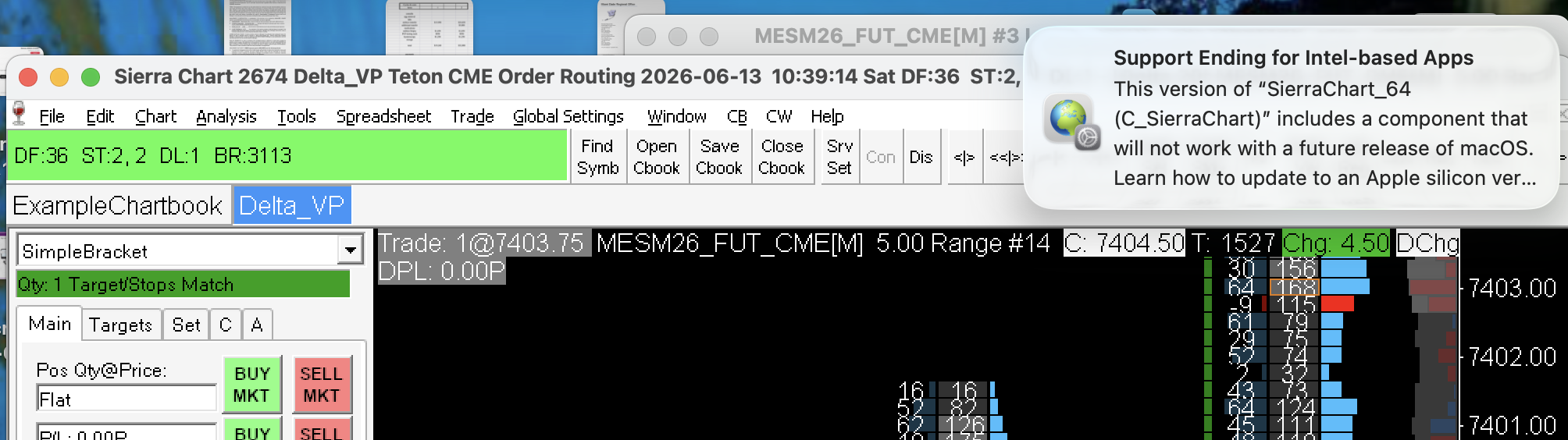

have you or anyone in this chain seen the attached notification on your Mac about "SierraChart_64 (C-SierraChart) has a component that will not work with a future release of macOS" and update to Apple Silicon version? If so, what SC version are you using with Crossover and where did you find the correct SC version to use? Thank you for the support.

ForgivingComputers.com - Posts: 1253
I responded to your email, and I am sharing this for the record. You stated you are using Crossover, which is the source of the error message.
That version of Sierra Chart is very old. The current version is 2922. You should update your Sierra Chart at least once a month.
The Popup appears to be from Crossover, and the part about "Intel-based Apps" means you are running SierraChart_64.exe and not SierraChart_ARM64.exe.
I recommend you update to the current version (Help>>Download Current Version) and only use SierraChart_ARM64.exe.

[2026-06-24 16:43:55]
User705490 - Posts: 17
Appreciate it. At this location for download for Mac:
Software Download
for current version 2922 select green button "download sierra chart (64-bit)" and not one of the other 2 options named Mirror 1 or Mirror 2, is that correct?
[2026-06-24 16:45:36]
Any of the three will work.
