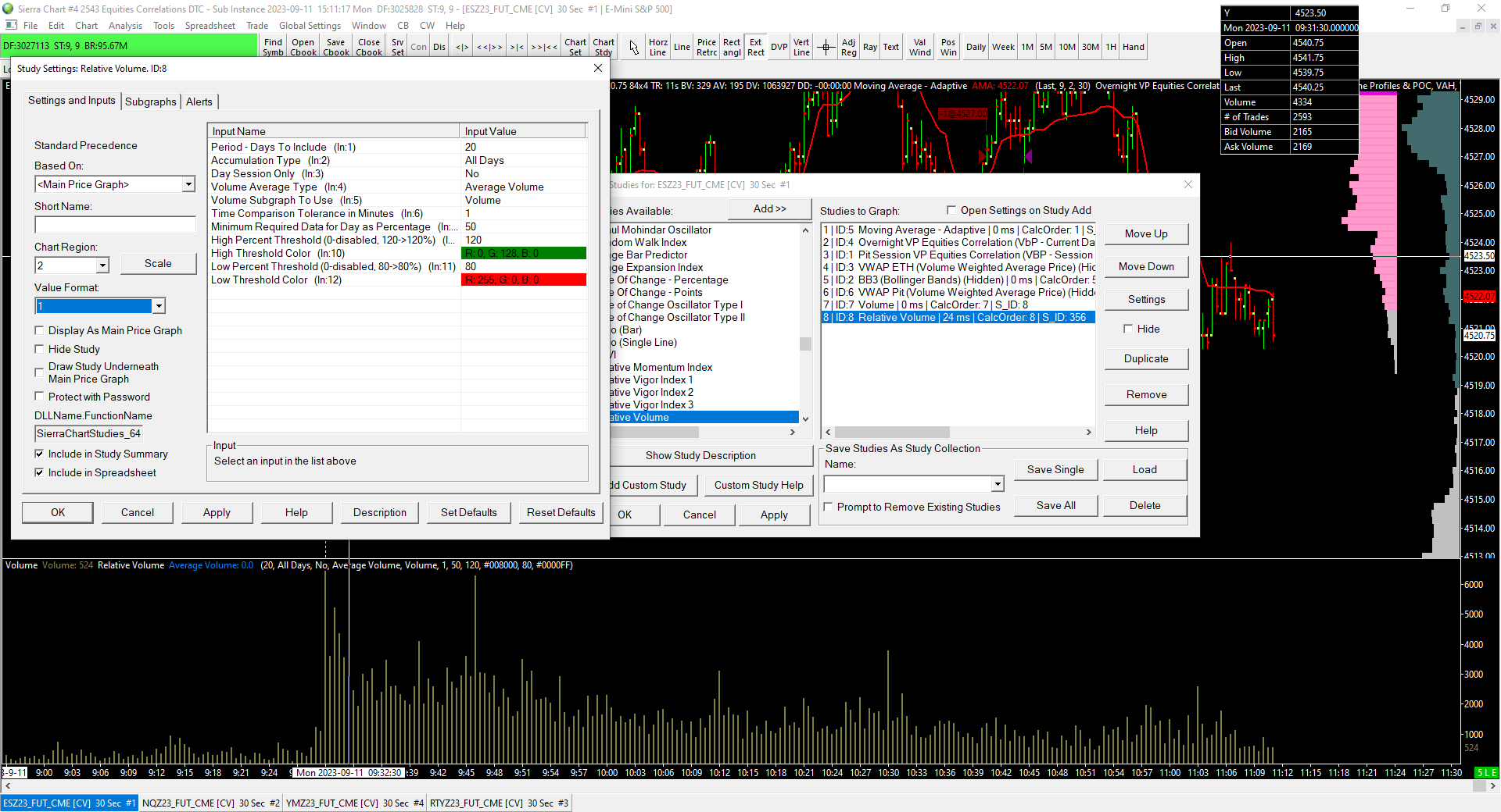

I am having been trouble with the relative volume study in one of of my chartbooks that is in a subinstance
What I am trying to do is display an average volume with respect to volume subgraph.
The study has been working however for me but this is the second time it does not ? Last ime I just kept changing different variables and was able to get it to display again but not sure what i did.
I have other chartbooks in the same subinstance with the same settings and they are displaying the average volume line for me no problem.
I have recalculated and reloaded the chart data and deleted and downloaded data. I did rollover the charts today but i did that for other charts where i am not having the problem. Also if i go back to the old contract i still cant get it to display.
Is it the fact that I am using a 30 sec chart interval ?
Would appreciate your input. Let me know if you need any other information. I believe i have the average line selected to display correctly in the subgraphs section.
Thank you
imageRelative volume.PNG / V - Attached On 2023-09-11 15:28:05 UTC - Size: 170.82 KB - 236 views

What is it about the study that makes you say that it is not working properly?
Keep in mind that the "Relative Volume" is going to look at the same time period for each day going back however many days you specify (assuming you have that many days loaded in the chart). It is not a Moving Average of the volume. Refer to the information for this study here:

Steve Leon - Posts: 319
thank you
your comments helped me resolve the problem
i was not loading enough days for the calculations to be carried out
thanks again
