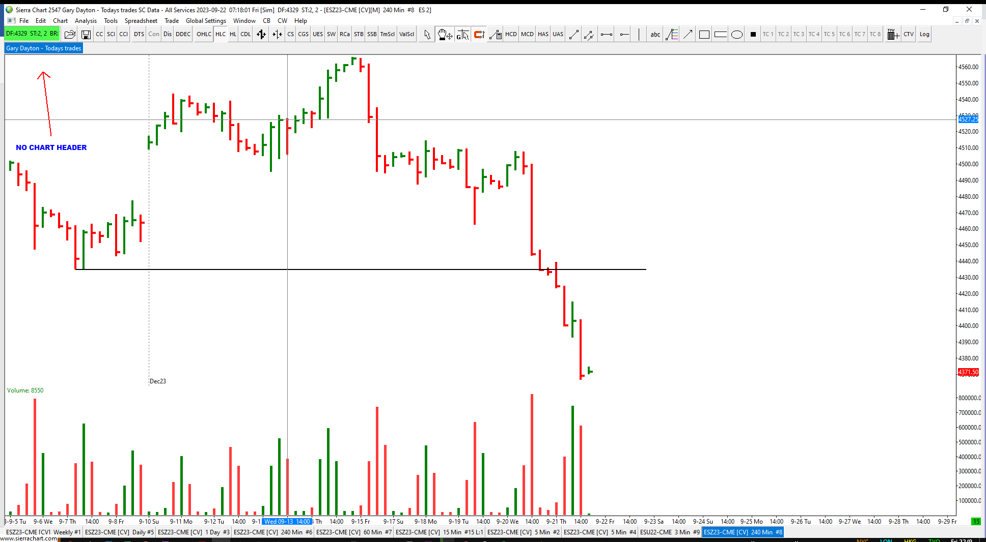

Can you please give us a screenshot of what you are seeing when this occurs. Follow the instructions at the following link to get us an image: Support Board Posting Information: Attaching or Posting a Screenshot/Image (Optional) For the most reliable, advanced, and zero cost futures order routing, use the Teton service: Sierra Chart Teton Futures Order Routing |
| [2023-09-21 23:18:53] |
| User629461 - Posts: 213 |
See screen image in attached link https://www.sierrachart.com/image.php?Image=1695338284968.png |
| [2023-09-22 14:22:54] |
| John - SC Support - Posts: 48527 |
We have seen this a few times, but we have never been able to reproduce what causes, and hence be able to find a fix. The general issue is that the graphics are shifted up, just enough that you can not see the Chart Header line. If you can give us a workflow that reproduces this for you, that would be very helpful. For the most reliable, advanced, and zero cost futures order routing, use the Teton service: Sierra Chart Teton Futures Order Routing |
