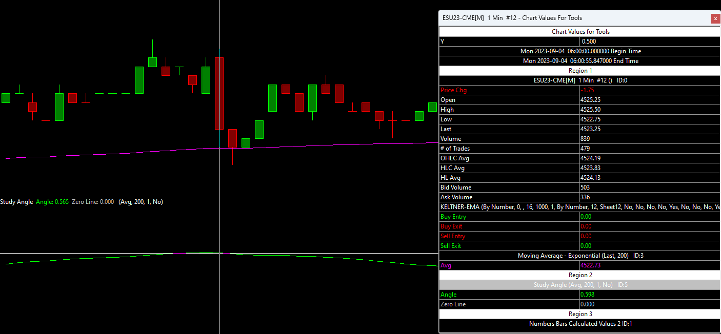

I use Study Angle to retrieve the angle of a 200 EMA.
It looks like the slope/line (green) of the Study Angle does not match the slope/line (purple) of the 200 EMA.
See attached image for lines, values and settings.
Is this correct or do i need to change settings?

The Slope of the Study Angle is not going to match the slope of the 200 EMA line, as you have the "Study Angle" input for "Length" set to 200. Therefore, you are finding the average angle of the moving average.
It does not sound like this is what you want, therefore we recommend changing the length of the Study Angle to something smaller, perhaps even 2, depending on how granular you want to view the data.
