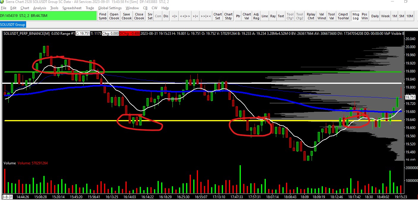

I wanted to set up an alert for each time price "goes out" of value area. I'm using the "VbP Visible Bars" study.
For further explanation, I attached a screenshot. I would like that each time price reaches or preferably goes beyond the green or yellow line, I would receive an alert. Is it possible?

[2023-09-01 21:27:20]
Within the Volume by Price study, the Value Area High and Low are stored in the SG3 and SG4 subgraphs, respectively. Therefore to test if the current price is above the Value Area High, you would use the following formula:
=L > ID1.SG3
Where L is the alert shorthand for the Last price and ID1 is the ID of the Volume by Price study.
To test if it is outside of either band, you would do the following:
=OR(L > ID1.SG3, L < ID1.SG4)
Refer to the following:
