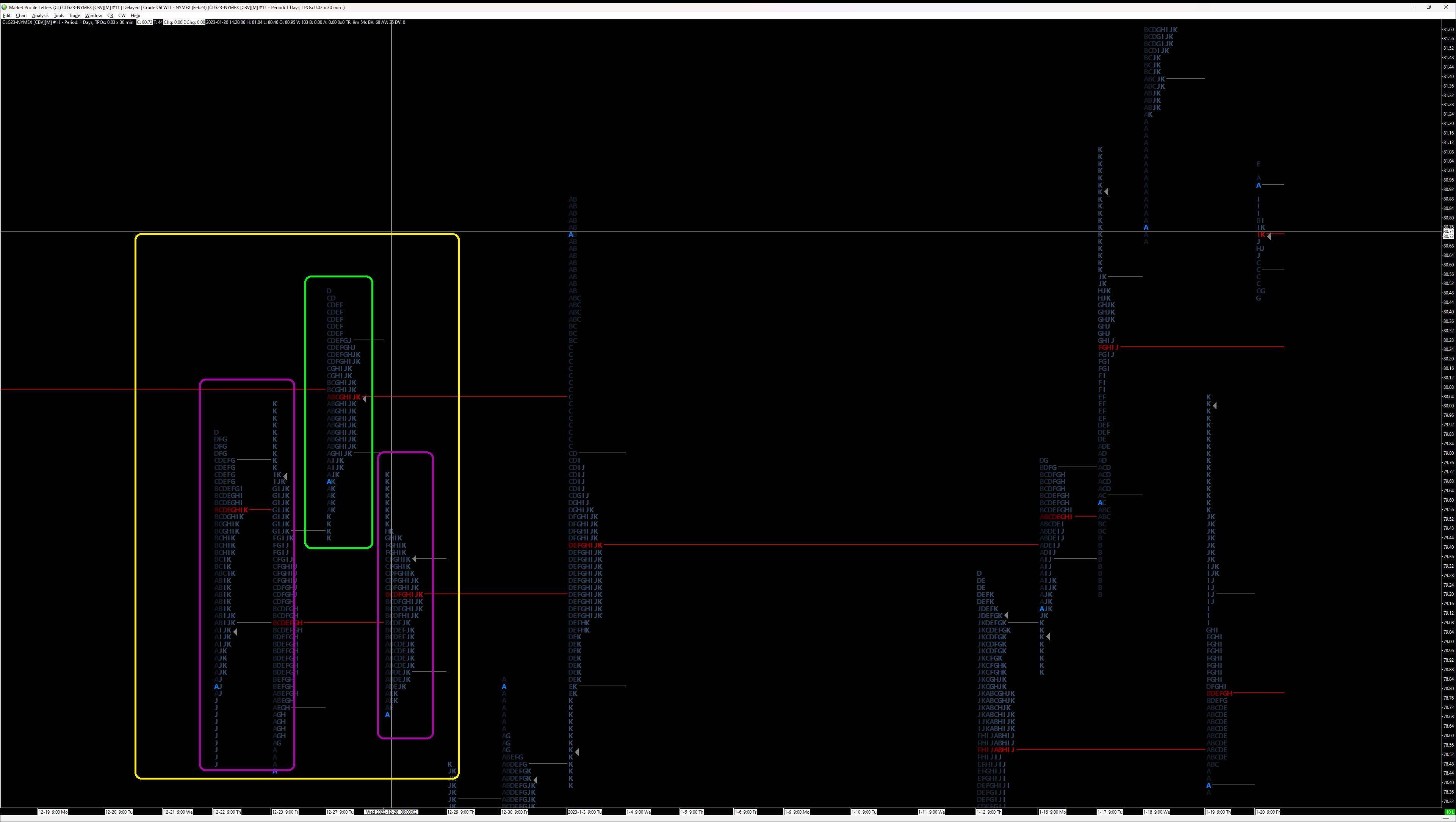

Moin Moin.
As merging market-profiles is, as far as I understand it, driven by accumulating asymptotically negligible price-distributions in the Lindeberg-Feller-Theorem´s sense ("https://encyclopediaofmath.org/wiki/Central_limit_theorem"), it seems sensible.:
1. for the attached screenshot regarding the days encased within the yellow box.
___a. to be able to merge the purple ones into a "pretty normal" distribution,
___b. whilst leaving out then green one, which does violate the asymptotical neglibility.
2. Right now I seem to be able to merge only the ones within the contiguous yellow time-area.
If You are trying to see, where value has been building in the nv@g7fx.com ´s sense (, who is, by the way a big fan of SierraChart),
then it seems to be sensible to see, where value has been built, after an imbalance failed to establish a new value-zone.
So, my question is, whether this is possible.

[2023-08-27 18:50:11]
You are able to exclude specific days from a chart which should then accomplish what you want. Refer to this Chart Setting:
Chart Settings: Set Dates To Exclude (Button) (Chart >> Chart Settings >> Chart Data >> Chart Data menu)

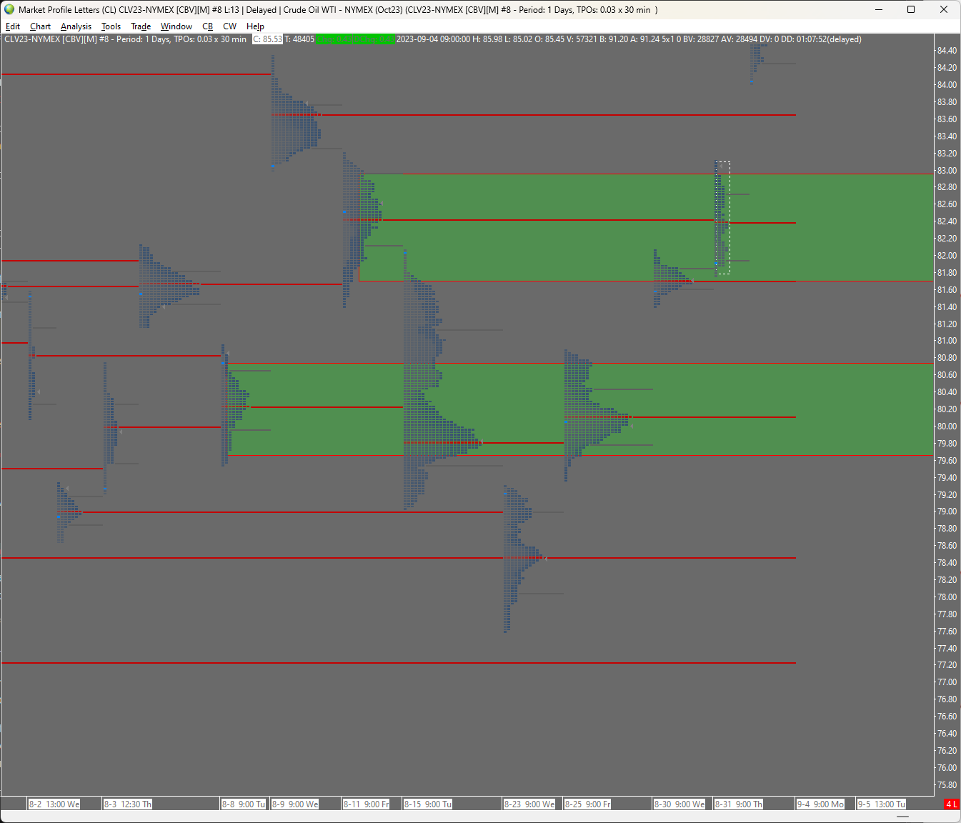

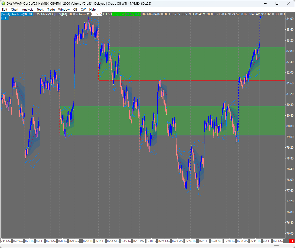

User408639 - Posts: 83
Moin Moin.
HAving tried the exclusion, I found, that it necessitates to create a new chart for every exclusion, if I
want to acurately calculate the mean and standard-deviation (µ and σ).
So, if I want to create a market-hypothesis, taking into account approximately normal-distributed bulks, whose value has been built over several days with gaps in between, then I need to merge non-consecutive profiles.
I did attach screenshots showing, the two Composite Value Areas, comprising non-consecutive days.
If it is possible to programm such a study by myself, I am more than happy to do it, if You can point me to the right instructions.
_Cheers,
__Michael.
Date Time Of Last Edit: 2023-09-17 17:29:22

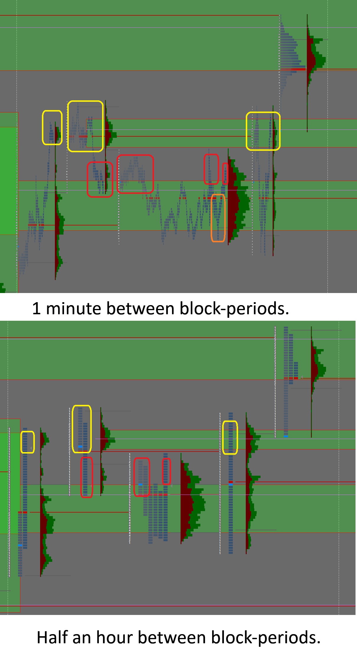

TL;DR.: Allowing to merge blocks that are separated by a split out group of blocks does add an extra-edge for traders.
Idea.:

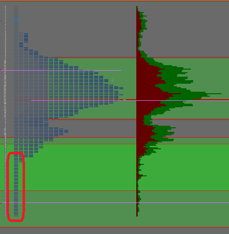

As I have been redoing Neerav Vadera's Trading-course, I realized, that.:
1. switching off the "Letters/Blocks in own column"-option does
  already
  aggregatate blocks, that are separated by "outlier"-blocks (this can be seen in "intermittent outlier.scrunched up.png" and "intermittent outlier.own columns.png" ).
2. we usually have many situations, where.:
  a.  gaps are being filled days later, but as split out blocks in the middle hinder the aggregation
    we do not obtain the Value area Low/PoC/High for these
  b.  using the "Letters/Blocks in own column"-option does this whithin a merged period
    , iff there are not many blocks in between worth splitting out.
It all comes down to "https://en.wikipedia.org/wiki/Lindeberg%27s_condition".:
Those blocks nicely adding up to a Gaussian shape do "submerge in the mass of blocks" (which is the meaning of Lindeberg's ondition justifying the usage of value-areas←"https://en.wikipedia.org/wiki/Central_limit_theorem").
Proposition.:
If You have samples showing me, how to implement something like this, I am willing to implement it.
For this there amy be different approaches.:
1. transform the effective feed, that the TPO-Study is using.
2. Create a new study with the capability to merge non-consecutive TPO-profiles, if I can use the very elaborate TPO-study functionality.
  Maybe this is possible by creating a study, base dupon the data of the TPO-Study.:
    So a Study².
_Tschüß,
__Michael.
Date Time Of Last Edit: 2024-01-21 15:12:50
imageintermittent outlier.own columns.png / V - Attached On 2024-01-21 14:11:54 UTC - Size: 10.99 KB - 312 views
imageintermittent outlier.scrunched up.png / V - Attached On 2024-01-21 14:12:04 UTC - Size: 8.1 KB - 293 views
[2024-01-21 15:09:01]
P.S.: There is an even better example of the filling-up outlier-scenario for ESz23 at 2023-11-01T11:30EST.
Ok the splitting occurred at the 30-minute-resolution-level, but still we see fillups at larger levels.
  Plus, the folloowing effect would be the same if we were handling 60 days instead of 2 with 30-minute-periods instead of 1 minute-periods.
1. within the lower image (30 minute-periods) we see balance spread out over two types of splits.:
  a. the first two yellow markers show a fillup over two days, that might have been avoided by just merging the days (no other blanced block of orders inbetween).
  b. The third yellow marker does show a fill up of the first two yellow zones, after(!) we had a balanced region (the three red markers) at a lower price inbetween.
2. within the upper image (1 minute-periods) we see that even within the former 30 minute-periods we can have other blanced block of orders inbetween.:
  a. the third (30 minute-periods) red marker within does comprise actually two red markes (1 minute-periods),
  b. that are being split up by an intermittent im-balanced region at lower price (orange marker).
Date Time Of Last Edit: 2024-01-21 15:09:45
