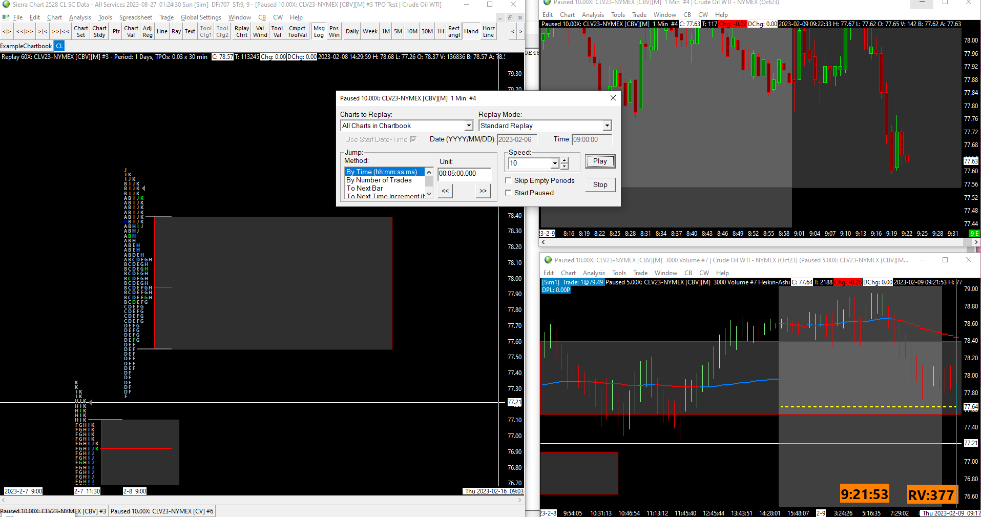

I have a Crude Oil TPO Chart Open and 5 min CL Candle Stick chart opened and Heiken Ashi 3000 Volume chart open.
When I am doing to a chart replay, At 9 AM start 2/9/2023 as in the picture, the Candle Stick chart and HA chart start showing the candles but the TPO does not, Why is this happening?
As you can see from the picture, I am 20 mins past 9 AM but no TPOs on the chart.
My Session time is same on all the 3 charts except on the TPO chart, I have disable the evening session.
imagemissing_tpo.png / V - Attached On 2023-08-27 05:28:32 UTC - Size: 115.21 KB - 188 views

Start by replaying the TPO chart by itself. See if it is working alone.
[2023-08-28 19:32:02]
pennydoll9 - Posts: 24
Yes, it works alone. How can I get all the 3 charts work at the same time, I have to simulate taking trades from a candle stick chart or a tick chart but look at a TPO chart?
[2023-08-29 14:04:16]
Then there is something about how the charts are setup that is causing the issue. The most common is simply starting a replay from where there is no data for that chart.
Also refer to the following regarding keeping charts in sync when running a replay:
Replaying Charts: Preventing Loss of Synchronization Between Different Charts During Replay
