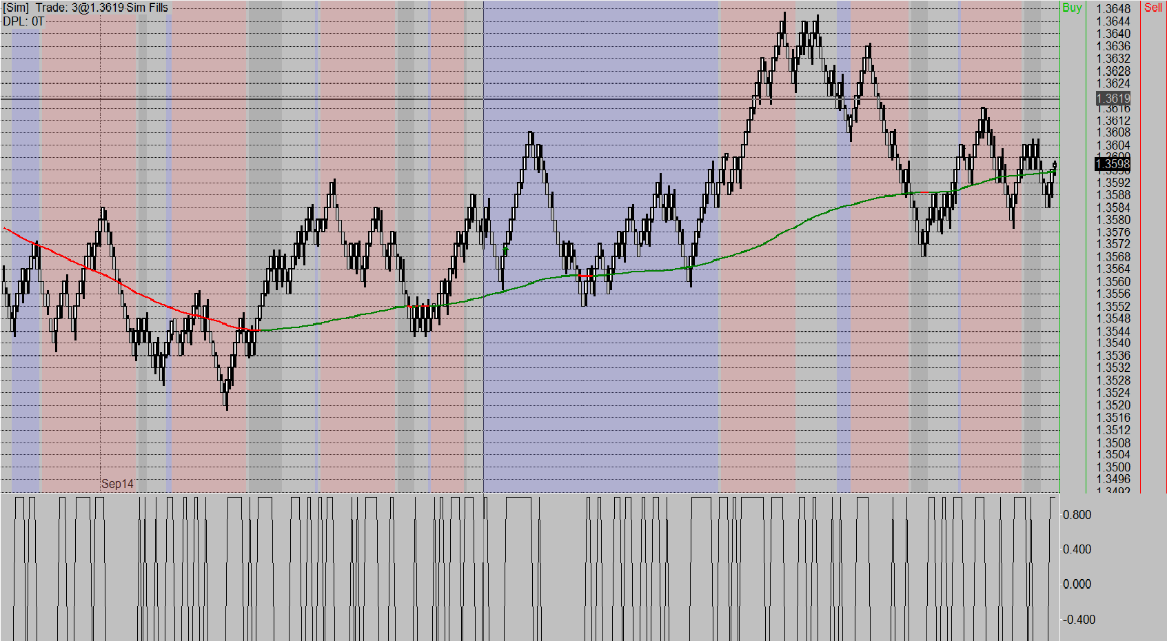

[2014-07-26 16:38:52]
vegasfoster - Posts: 444
I did this, but the plot wasn't coming out, see pic. I went through it a couple times and my translation error didn't jump out at me. The only way I know how to resolve this is to break it down by section and compare the plots for the calculations on SC vs NT. However, I don't have NT installed and I have yet to find the motivation to follow through on this. So I am going to post what I have, see attachment.
Unless someone else already finished this for you, maybe you can take a look and compare the codes and try to see where it is going wrong, if not then next step is to start going through the individual calculations and comparing to NT. Understand, it may not be exact because of how each program calculates the bar data, but looking at the plot you will be able to see if it working correctly or not.

[2014-07-27 21:58:12]
crazybears - Posts: 314
thanks vegas i try to work on your code
[2014-07-27 22:16:42]
change
SCSubgraphRef stepmaout = sc.Subgraph[11];
SCSubgraphRef trendout = sc.Subgraph[11];
to
SCSubgraphRef trendout = sc.Subgraph[12];
[2014-07-28 04:53:25]
Pfft, see wasn't even looking at that, glad you figured it :-)

Converting MT4 indicator StepUp for Sierra charts
Regards,
Nicolaas
[2024-04-27 22:44:50]
User411320 - Posts: 379
I downloaded and put the STEPma in the data folder but don't see it. please help
