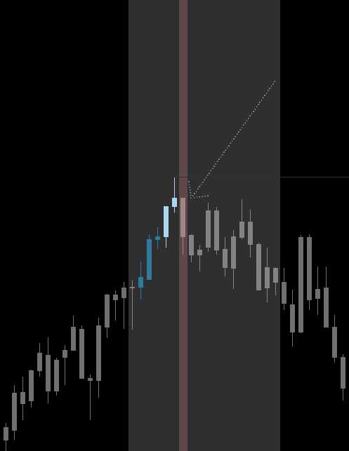

Hi, I am trying to create a CBBOAC for a reversal and wondering if someone can help with the Syntax.
The desired output is an Alert Condition = 1 after 3 bars of a separate CBBOAC and then the condition is no longer valid. I've attached a screenshot as an example.
Here is what I have so far:
=AND(ID25.SG1= 1,ID25.SG1[-1]= 1,ID25.SG1[-2]= 1,ID25.SG1[-3]= 1)

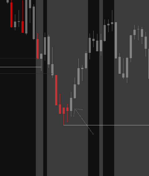

I've included a screenshot for reference.
The grey shaded area is the initial condition (ID50.SG1=1). The red bar is the reversal bar and entry trigger(AND(ID26.SG1= 0, ID26.SG1[-1]= 1, ID26.SG1[-2]=1).
I'd like to get it to where I can remove the grey shading and only see the entry trigger when both studies are valid.
Appreciate all of your help!

[2023-09-07 22:09:24]
Sawtooth - Posts: 4361
I'm sorry, forgot to mention that you'd have to convert the spreadsheet syntax to Alert syntax for use in the Spreadsheet Formula study, where you can use that study to create a persistent variable.
It looks like you don't need a persistent TRUE after all.
It seems this should work. Tell me what this gives you:
=AND(ID26.SG1= 0, ID26.SG1[-1]= 1, ID26.SG1[-2]=1, ID50.SG1 = 1)

User185631 - Posts: 12
I still can't get them both to work as one Alert. But they work when I try them separately.
Attached another example. There should be a signal on the bar with the arrow but it's still not showing.
I may just try and leave them separate and then make another alert where both = 1.
