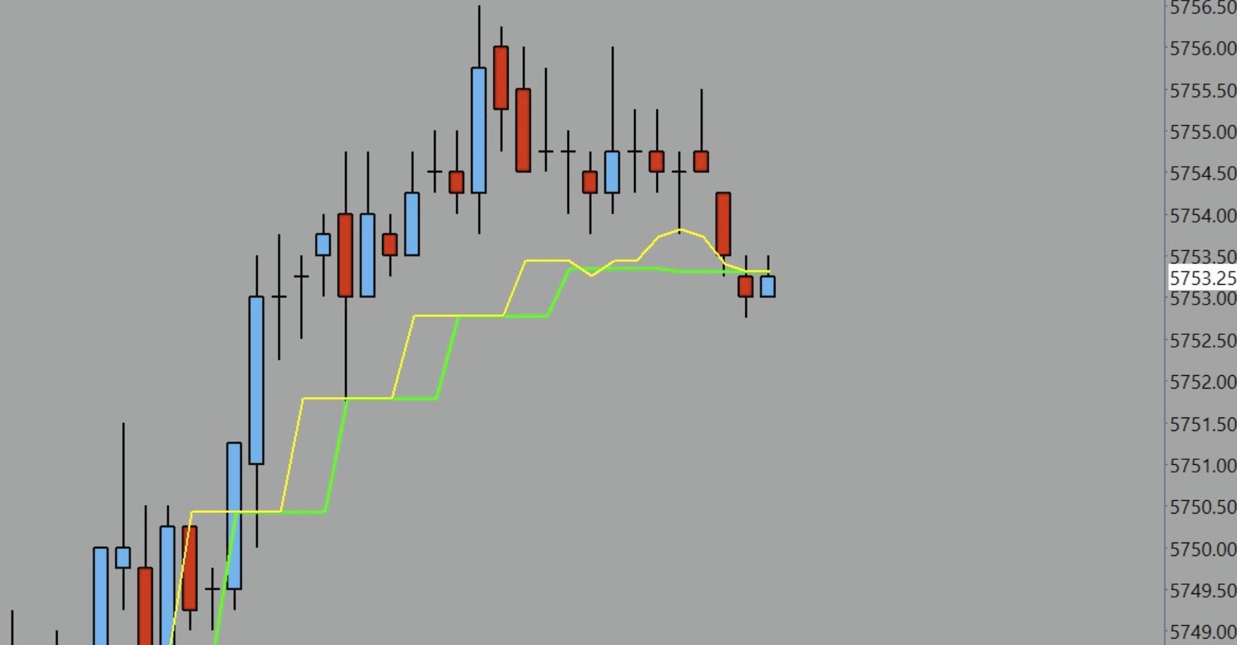

cmet - Posts: 747
Here's something that updates a higher time frame average based on a lower time frame. This requires overlaying your EMA from the higher time frame onto the lower using Study/Price Overlay. The study then pulls the tick by tick data from the overlay without having to access another chart window.
I'm sure someone else has a more elegant solution but this seems to work. You can check for accuracy and tweak.
Image is of an ES 1 min with the 5 min overlay (green) and the live update plot (yellow) that will return to stair step when chart is reloaded.
Date Time Of Last Edit: 2025-05-12 01:09:34
attachmentMTF_EMA.cpp - Attached On 2025-05-12 01:05:35 UTC - Size: 1.49 KB - 444 views
imageMTF EMA.jpg / V - Attached On 2025-05-12 01:06:12 UTC - Size: 90.97 KB - 492 views
