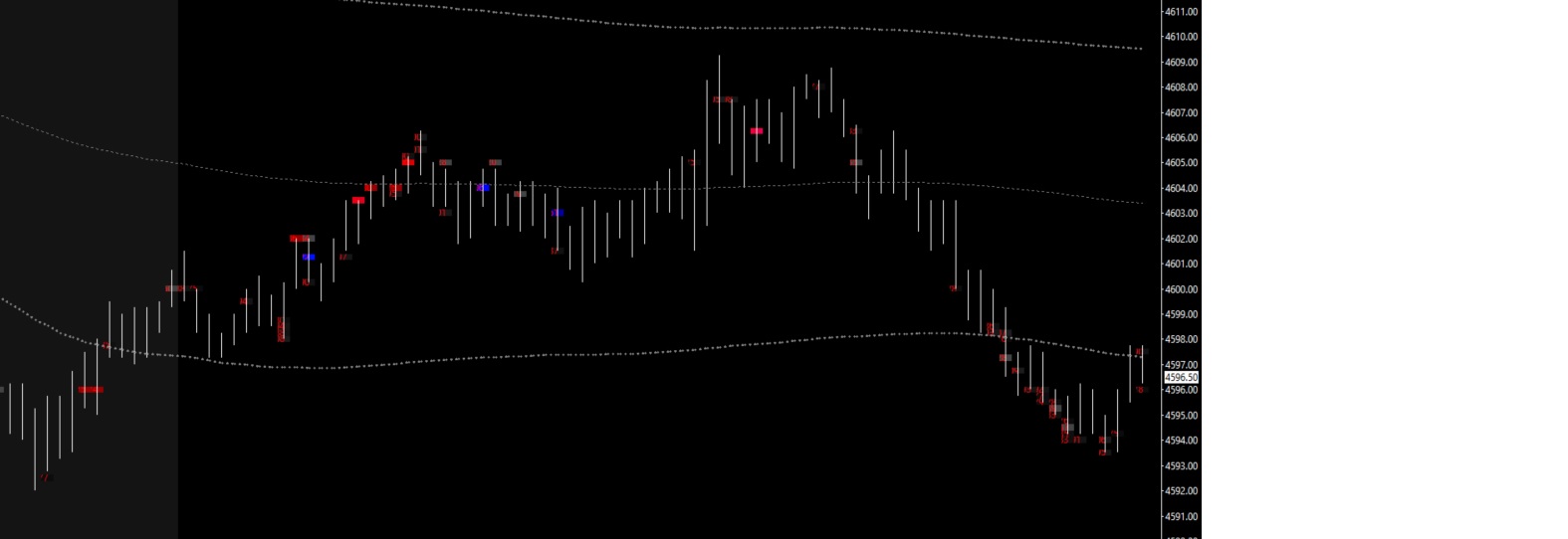

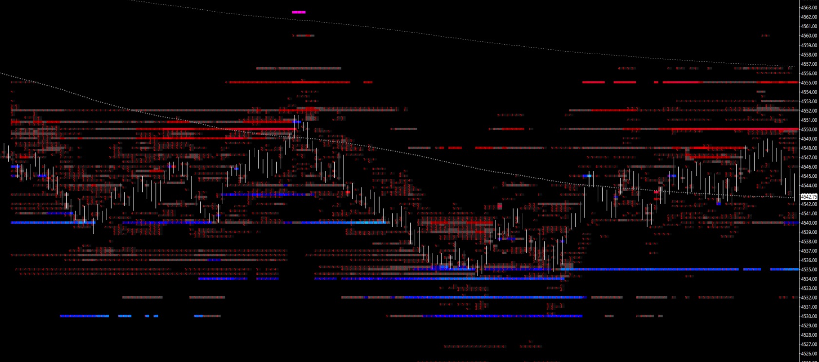

I have followed your steps and taken two screenshots. The first screenshot is from Aug. 1st, the day before I activated the data and I see a few red marks on each bar. Then when I look at Aug 2nd, you can see how much more data is available. Is it possible to have that same level of historically data available?

[2023-08-03 18:22:53]
What is the symbol for this data?
[2023-08-03 18:45:20]
jrob - Posts: 22
ESU23_FUT_CME
[2023-08-03 19:13:24]
Please try to redownload the historical market depth data by following the instructions at Step #8 at the following link:
Market Depth Historical Graph: Downloading Of Historical Market Depth Data
Be sure to go back before August 1, 2023 and then right-mouse click and select the option for "Download Depth Data From Date-Time". It can take a few minutes to download, depending on how much data it needs to get.
[2023-08-03 19:40:48]
jrob - Posts: 22
Thank you so much, that resolved my issue! I was not aware I needed to go back to the actual date and click 'Download Depth From Date-Time', I assumed it would pulled that from the SC Server Settings.
[2023-08-03 21:40:19]
When you do not automatically get the data for a certain time, then you need to use that option.
