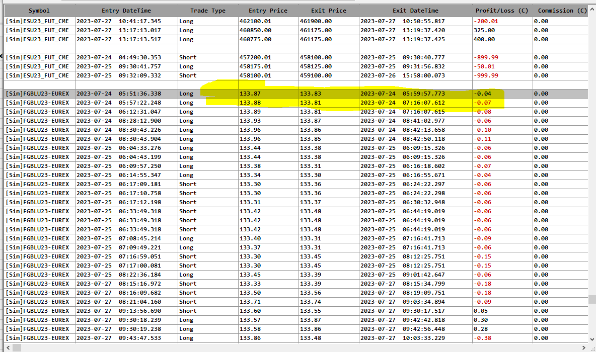

I have noticed some errors with the P&L column on the Trades (Activity Log).
The Tick size appears to be calculating wrong for Product FGBLU23.
i.e. It looks like the decimal place is wrong 0.04 should be 0.40
I've noticed the the symbol setting commission has also reset to 0. Will that be updated or do I need to add it myself on symbol settings?

imageTrade Log P&L - sierra chart.PNG / V - Attached On 2023-07-29 13:32:36 UTC - Size: 90.22 KB - 184 views
[2023-07-29 23:48:37]
Sierra_Chart Engineering - Posts: 25412
That does not make sense, every tick should be equal to €10.
There should never be a profit or loss less than €10.
Refer to:
Profit/Loss Calculations and Symbol Settings
Date Time Of Last Edit: 2023-07-29 23:48:49
