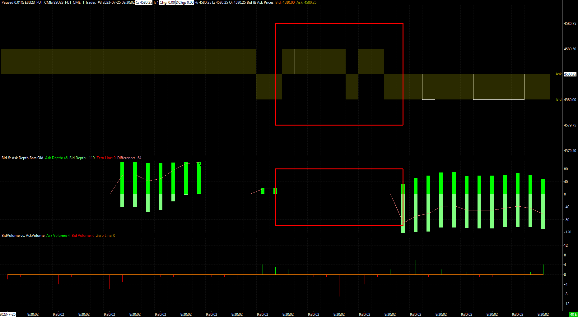

| AndyB - Posts: 111 |
https://www.sierrachart.com/image.php?Image=1690293466659.png As you can see, there was a quick back and forth of the bid and ask prices in the main graph. No depth populated during this time, which isnt surprising if market orders were moving faster than depth from the CME could update. However, upon watching the replay on the DOM, there absolutely was updating depth during this time. This example was from this morning, about 30 minutes ago. I should also note that this is using the "Combine Trades into Original Summary Trade" setting under Chart Settings >> Chart Data, if that makes a difference. |

| Sierra_Chart Engineering - Posts: 25425 |
We will look this over. But we think it is timestamp related.

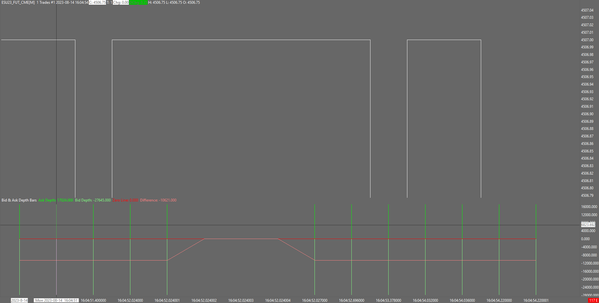

Sorry, somehow just seeing this. Attached is the image you requested. This is ES from a few moments ago. https://www.sierrachart.com/image.php?Image=1692043551480.png |
Yes this does make sense to us. Trades have a microsecond portion that market depth data does not. So where you see a nonzero microsecond portion of a timestamp we would not expect to see market depth data on those bars. Not sure why you see it on the .001 microsecond timestamps. The microsecond portion, is from .000001 to .000999 Sierra Chart Support - Engineering Level Your definitive source for support. Other responses are from users. Try to keep your questions brief and to the point. Be aware of support policy: https://www.sierrachart.com/index.php?l=PostingInformation.php#GeneralInformation For the most reliable, advanced, and zero cost futures order routing, use the Teton service: Sierra Chart Teton Futures Order Routing Date Time Of Last Edit: 2023-08-14 21:02:17
yes that makes sense, however im still seeing updating depth in the replay where its not showing on the 1 t chart
