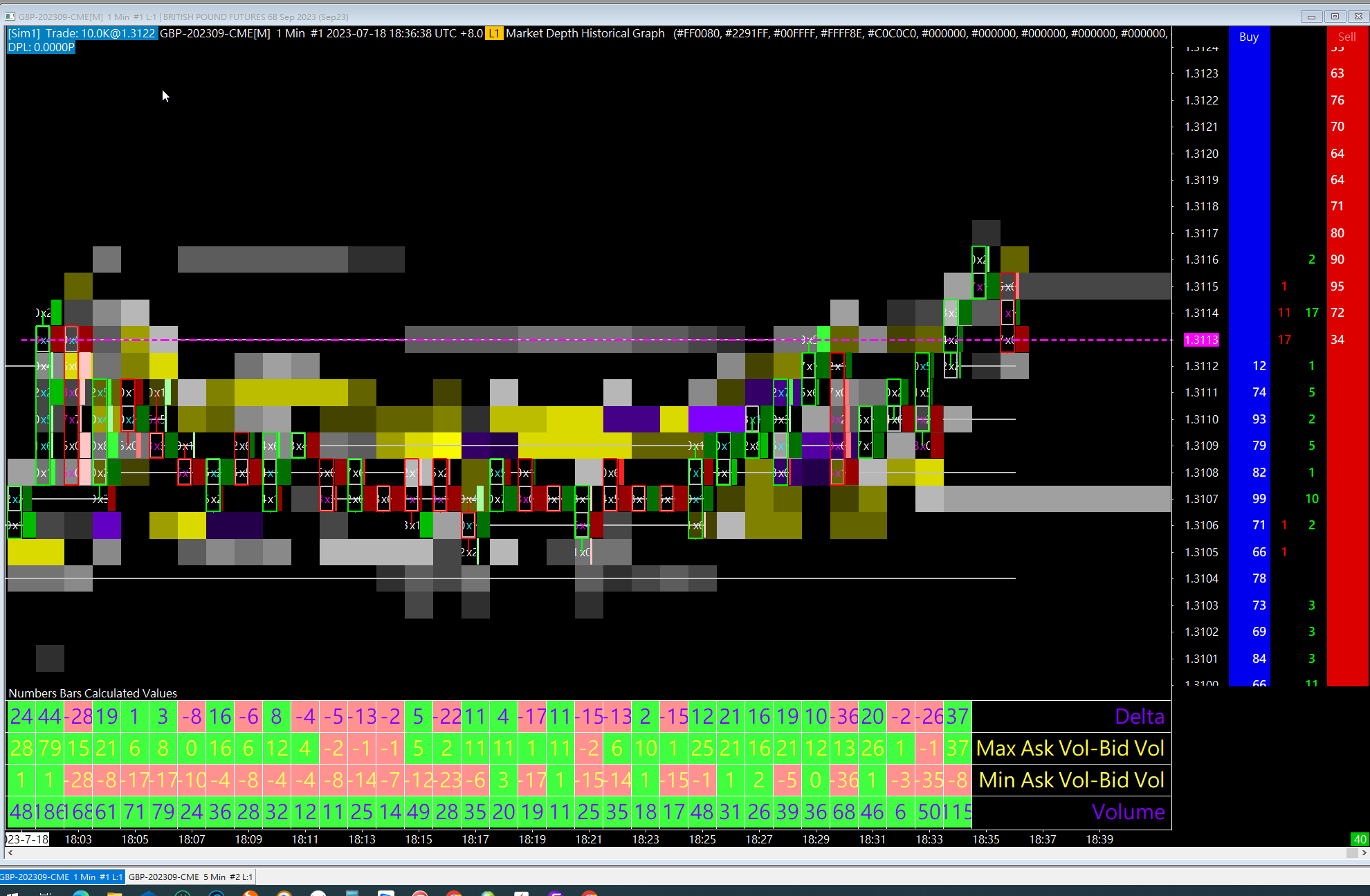

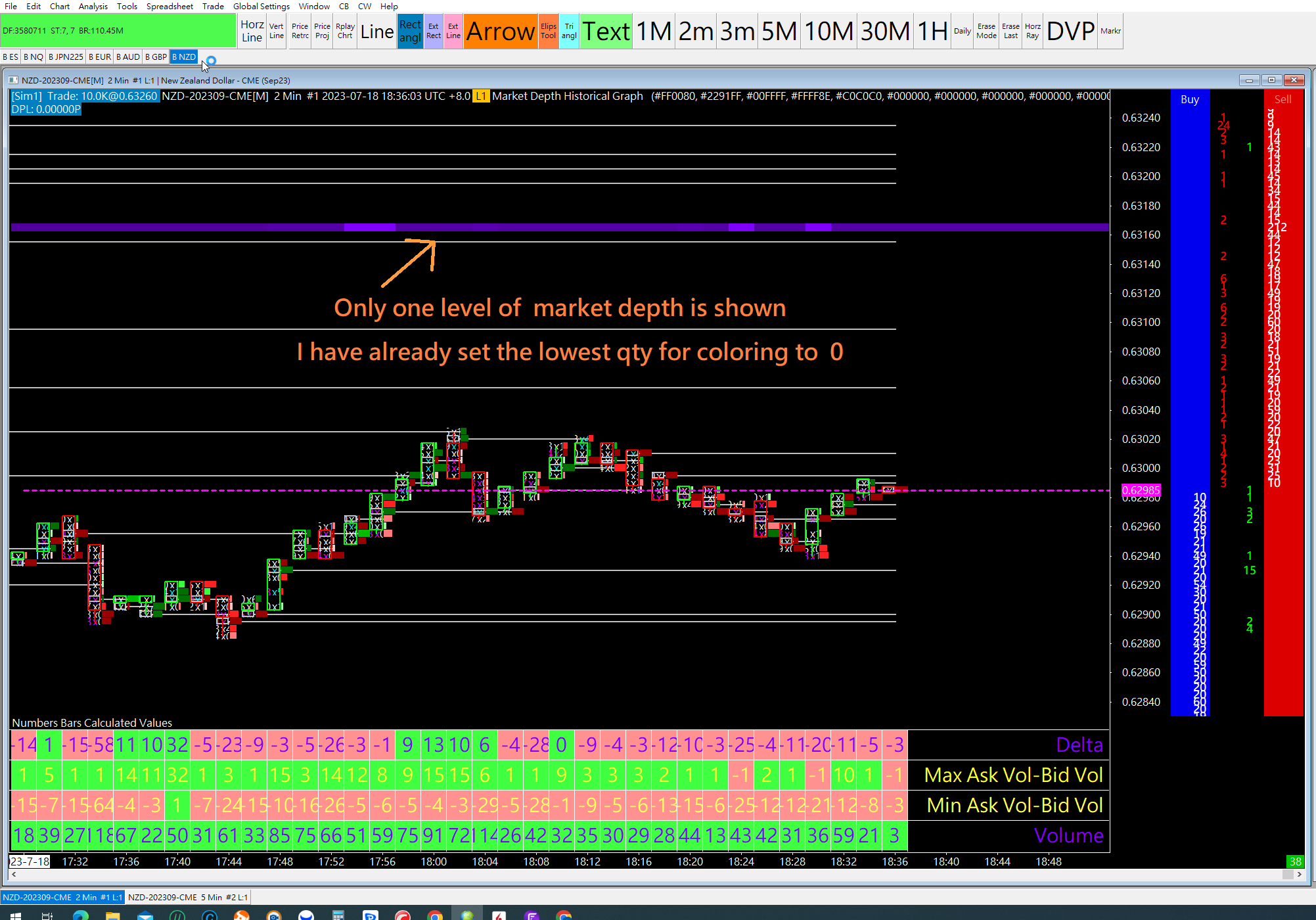

Enclosed please find two pictures. GBP and NZD futures.
Please note that the two charts has THE SAME template and market depth history graph study setting .
I have got the full level of market depth history graph in GBP but only got one level in NZD.
Please advise how I can have the full levels in NZD ( same as GBP ).
imageScreenHunter 699.png / V - Attached On 2023-07-18 10:46:49 UTC - Size: 193.71 KB - 243 views
imageScreenHunter 700.png / V - Attached On 2023-07-18 10:46:56 UTC - Size: 170.53 KB - 214 views

There are so many Inputs for the Market Depth Historical Graph that can affect how it is displayed, so it's hard for us to pinpoint what is occurring in your case.
In particular, if you are not using relative values for the "Threshold Levels" and for the "Highest Quantity for Coloring", then you can not use the same settings between instruments, as things are just different.
The first thing you will want to do is to make sure you are actually getting the levels displayed and they are not so dark you are just not seeing them. The best way to do this is to set the Input for "Show Quantity Numbers" to "In Bars Only" and then set the "Use Secondary Numbers Color for Quantities Greater Than or Equal To" to "1" and set "Secondary Numbers Color for Quantities Greater Than or Equal To" to a color that will stand out (such as Red or Hot Pink) for your particular setup and background.
Then make sure you are getting all the levels displayed. If not, then you would need to look at why this is the case given the setup you have.
