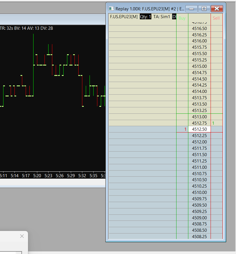

[2023-07-14 06:39:27]
User425645 - Posts: 123
I opened up a whole new chartbook, opened a new default intraday chart along with a new default DOM for F.US.EPU23. The DOM has all depth levels at the current date-time, but when I try and replay the chartbook it I get the same issue.
imageScreenshot 2023-07-13 233854.png / V - Attached On 2023-07-14 06:39:15 UTC - Size: 44.84 KB - 245 views
[2023-07-14 09:06:08]
Have you verified you have historical market depth data for the particular Date-Times you are replaying? You need to actually see it on a chart using the Market Depth Historical Graph study:
Market Depth Historical Graph: Market Depth Historical Graph Not Displaying
[2023-07-14 14:02:41]
We did not realize that this was a Trading DOM. The most likely situation is that you do not have the "Days to Load" set correctly for the Trading DOM. Refer to the following:
Replaying Charts: Replaying Trade DOM Windows
