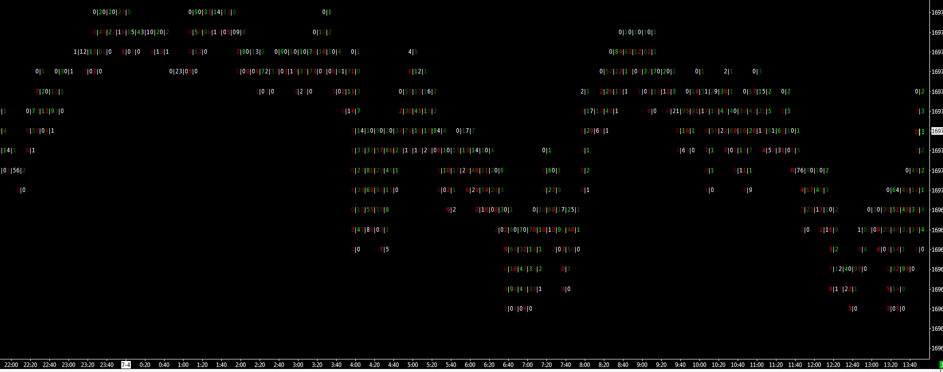

[2014-07-05 11:34:10]
Neo - Posts: 198
I'm currently trialing out Sierra charts with my IQ feed to see if I want to switch over from Market Delta.
I'm trying to setup a "foot print" volume imbalance chart for the YM, which I believe is refereed to on here as a Diagonal comparison. However i'm having trouble with the scaling.
What am I doing wrong?
imagevol bal.png / V - Attached On 2014-07-05 11:33:24 UTC - Size: 43.52 KB - 910 views
[2014-07-05 11:46:51]
The bar spacing looks very close. Refer to this section here to change the bar spacing and also the vertical scaling:
http://www.sierrachart.com/index.php?l=doc/doc_NumbersBars.php#Scaling
Also the overall appearance is based upon the Input settings you have set. If the overall appearance is not as you require, you will need to change the settings. Here is the documentation for those:
http://www.sierrachart.com/index.php?l=doc/doc_NumbersBars.php#InputSettings
It is somewhat hard to understand what it is you are trying to point out as the issue with this chart. The study is highly configurable and we do not know what your intentions are relative to what we are seeing.
[2014-07-05 12:52:18]
Neo - Posts: 198
Thanks for the prompt response. First class.
I thought I'd used the wrong input settings, but it looks like all i needed to do was play around with the manual scaling.
Cheers.

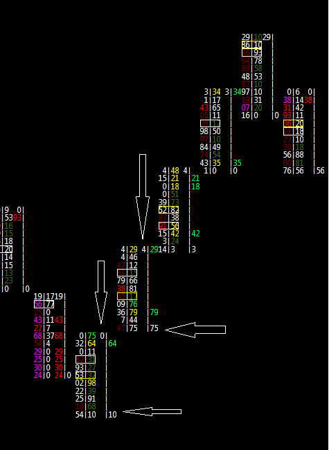

[2014-07-05 14:01:39]
Neo - Posts: 198
I've got my chart setup now, i'm impressed. Would of liked parameters for a 4th range color/ threshold, but it's already looking more versatile than MD.
Just wondering if I can change the top/bottom, bid/ask into black? as per the other values in my 2nd column.
Cheers.
imageYM flow.png / V - Attached On 2014-07-05 13:53:43 UTC - Size: 22.09 KB - 898 views
[2014-07-07 16:36:07]
What do you have the Column 2 Text Coloring Method input set to?
What do you have the Column 2 Comparison Thresholds input set to?
Date Time Of Last Edit: 2014-07-07 16:36:46

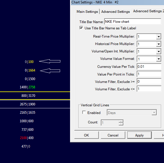

[2014-07-09 11:40:53]
Neo - Posts: 198
I'm talking about bid vs ask, however i'm referring to how it's calculated in the study.
I don't want trades with a zero value on the bid or ask side, to be included in my diagonal comparison study. So in the image posted i don't want the top two trade prints(100 & 1664) to be highlighted, as it's giving a false sense of strength. eg Yellow is my top threshold which is set to 500, however if a 100 lot goes through and it's being compared to a zero lot on the other side, then that's hardly relevant, and gives no indication of strength. It just clutters my study.
The volume filter just reduces the volume amount on each side, but will still color the prints if they remain x amount greater as per the threshold set. If in the same example below I adjust the bid/ask threshold to 1, then that would just hide the zero's from 'view', however i'll still end up with the 100 & 1664 left highlighted.
imageVL filter.png / V - Attached On 2014-07-09 11:38:42 UTC - Size: 19.37 KB - 783 views
[2014-07-10 17:23:03]
OK we understand the problem. This will be solved in the next release.
