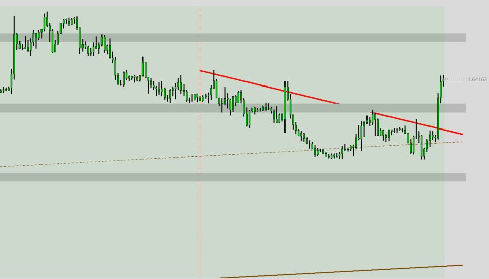

Could I please get some advice as to what settings to change to be able to see drawings and not have them under other drawings?
In the picture I have a zone drawn by a Horizontal Line and any drawing that interconnects with it does not allow to see it such as the red Ray line.
I have looked in Support Forum and SC instructions but have not yet been able to resolve the issue.

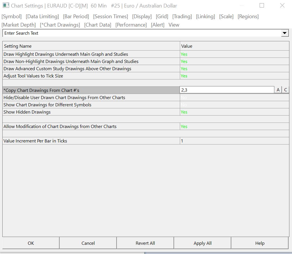

[2023-07-06 14:40:59]
It depends on how the horizontal line is being drawn. If this is another drawing, then it depends on the order in which the drawings are done. Newer drawings will be on top of the older ones.
If the horizontal line is from a study, then you need to change the setting for "Chart >> Chart Settings >> Chart Drawings >> Draw Highlight Drawings Underneath Main Price Graph and Studies", and also the one below this for Non-Highlight Drawings, to "No". Then the drawings will be on top. But there is only the two options, above everything or below everything, so you may not get exactly what you want (below some, but above others). Refer to the information here:
Chart Settings: Draw Highlight Drawings Underneath Main Graph and Studies (Chart >> Chart Settings >> Chart Drawings menu)
