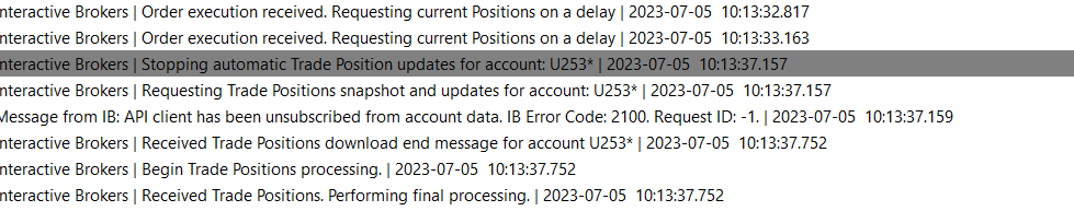

Last weekend I upgraded from Build 2466 to 2517, Today I made 3 trades, I used my usual 1 common stop , T 1, T 2 Bracket order set up on Sierra
Trade 1 it hit my stop, and OCO the 2 Limit buys, everything seemed fine after the upgrade
Trade 2, I could see it was going to hit my stop again and I hit Flatten and Cancel on my custom tool bar, which is my usual fast market out
The position line and all the orders disappeared and I assumed I was flat until I looked over and my IB TWS and I am still short 4 MES
Tried to flatten it again via Sierra and it says the Position does not exist. So I just killed it via IB TWS. Thought it maybe a fluke so tried again
Trade 3 . Exactly the same but only had 2 MES on and killed it right away when I could see the same thing. I took a look at the message log and there is something about API data from TWS
My P/L on Sierra trade window is only showing the $ 22 loss form the first trade and nothing from the other 2
Any idea how to fix this, Last upgrade I was a nightmare of compatiblity issues and I delayed this as long as possible until I saw the pinned thread about having to update by July 3
Barry

Ok, I read through all the stuff, The last 2 trades yesterday, on the Trading Activity log, there is no closing position, prob as I had to close it directly via IB, as Sierra said the position didn't exist, I when I think about it now there was no position line, or there was and it disappeared,
Today I tried to replicate it, Created a simple 4t ST, 4t T1 ,with 1 MES , sold at ask . got filled, No position line, tried to flatten and cancel right away , same thing , Position doesn't exist, but I can see I'm short 1, closed it via IB again, Same thing as yesterday, but as I hadn't changed anything since yesterday, I wasn't expecting a different result.
Seeing as this problem only started since I updated to build 2517, I decided to go back and install the old build 2466, Tried the same experiment and it worked fine.
Strange thing is when I closed it the Via IB the first try today, that trade is on the log, but its listed different , yesterday there were no closing trades there.( This is both on build 2517 )
another thing, the first trade yesterday worked ok when I let it hit my stop, So I thought everything was fine after the upgrade. but it seems I am stuck with the old build for now
Barry
