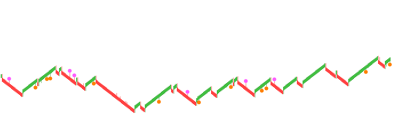

Anyone have alert study code to identify and color the outside bar of a flex renko chart.
with the pullback low of the outside bar needs to have been close becoming a reversal bar itself.
I would like to have the outside bar colored if its within 5 bars of the previous reversal bar.
I have attached a screen shot of what I'm trying to do.
imageoutside bar renko chart.PNG / V - Attached On 2023-07-04 02:40:19 UTC - Size: 6.58 KB - 360 views

Your pic is confusing.
You've marked 4 bars, the first is not an outside bar, and the third is not within 5 bars of a reversal bar.

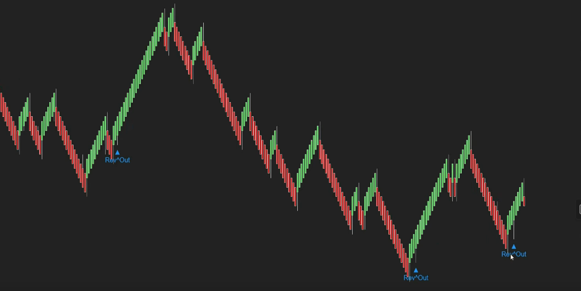

Im trying to replicate this NT chart indicator.I have included a screen shot.Its the pic with the black chart.
I found a previous post of yours here and been trying to get the code modified to fit what i need.
But no luck so far.

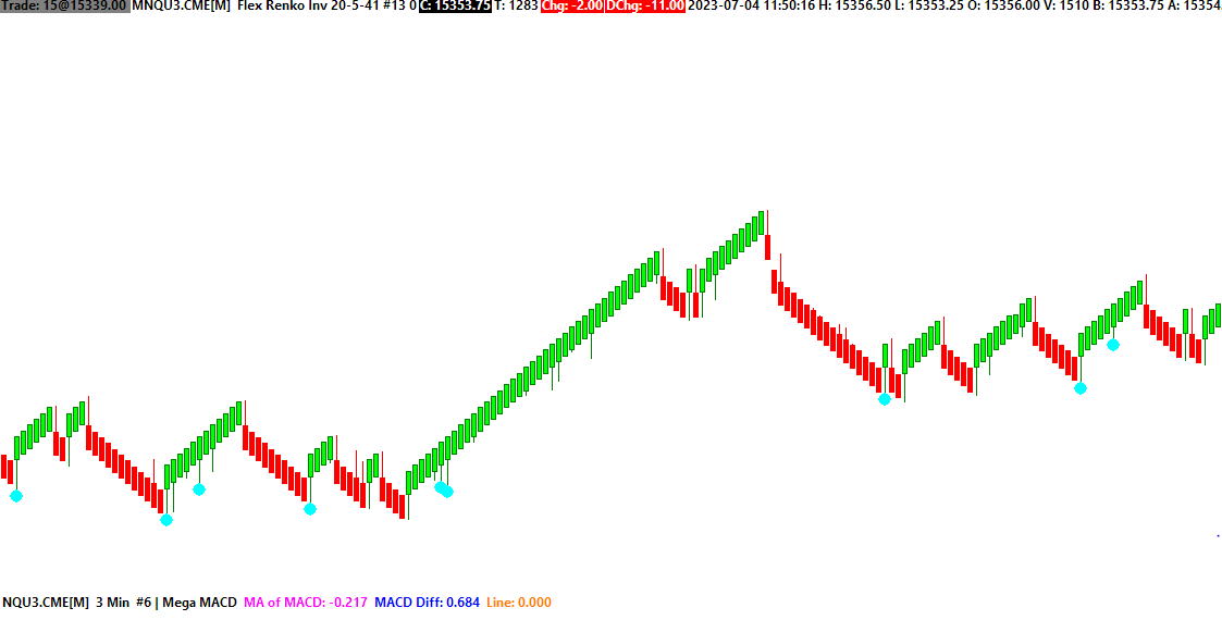

[2023-07-04 19:01:31]
Sawtooth - Posts: 4361
Try this:
=AND(
AVERAGE( ID28.SG1[0:-6]) >0,
AVERAGE( ID28.SG2[0:-6]) =0,
ID0.SG23[-1] > ID0.SG22[-1],
ID0.SG23 > ID0.SG22,
ID0.SG23 > H[-1],
H >H[-1],
OR(L < L[-1] ,L < L[-2]),
OR(L < L[-3] ,L < L[-4])
When dealing with Renko bars, the Open and Close are identified by ID0.SG22 and ID0.SG23 respectively:

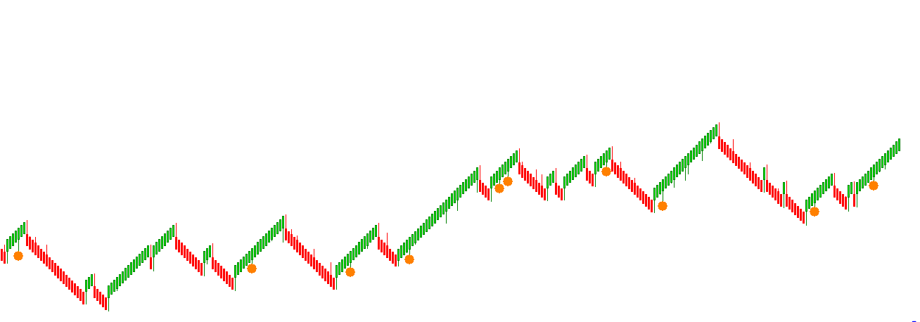

Code is almost there. It seems to miss a few bars i have marked them on the attached screen shot.
I would like the code to identify them, or would those bars not count as outside bars?
imageMy outside bar code renko chart2.PNG / V - Attached On 2023-07-04 22:10:21 UTC - Size: 14.89 KB - 329 views

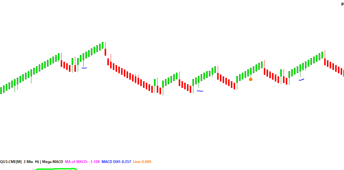

I modified you last code block and I think it is very close to what im looking for.
Screenshot attached.
