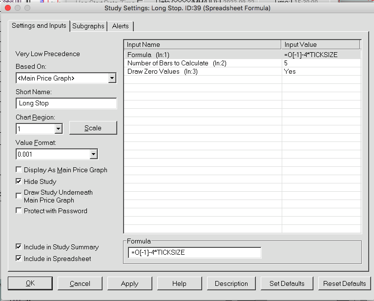

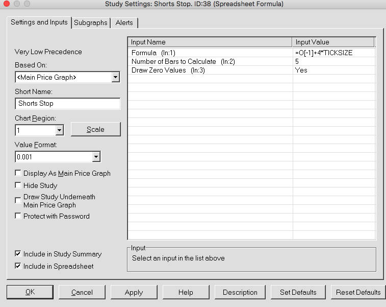

I have two spreadseht formulas with one formula for shorts =O[-1]+4*TICKSIZE
And another for long
=O[-1]-4*TICKSIZE

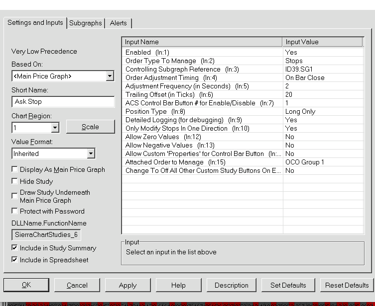

now I have two TMBS one for each formula with 20 tiks and OCO 1 group
My question is if it is necessary to activate the attach order in the trade window with a stop at 6 points and a target or is it not necessary? I ask this because it seems that it doesn't work well, thanks

[2023-07-03 21:26:56]
You have to have an attached order for the "Trade Management by Study" to manage. And you would need two copies of the "Trade Management by Study" - one for the Stop and one for the Target, if you are going to manage both of them.
