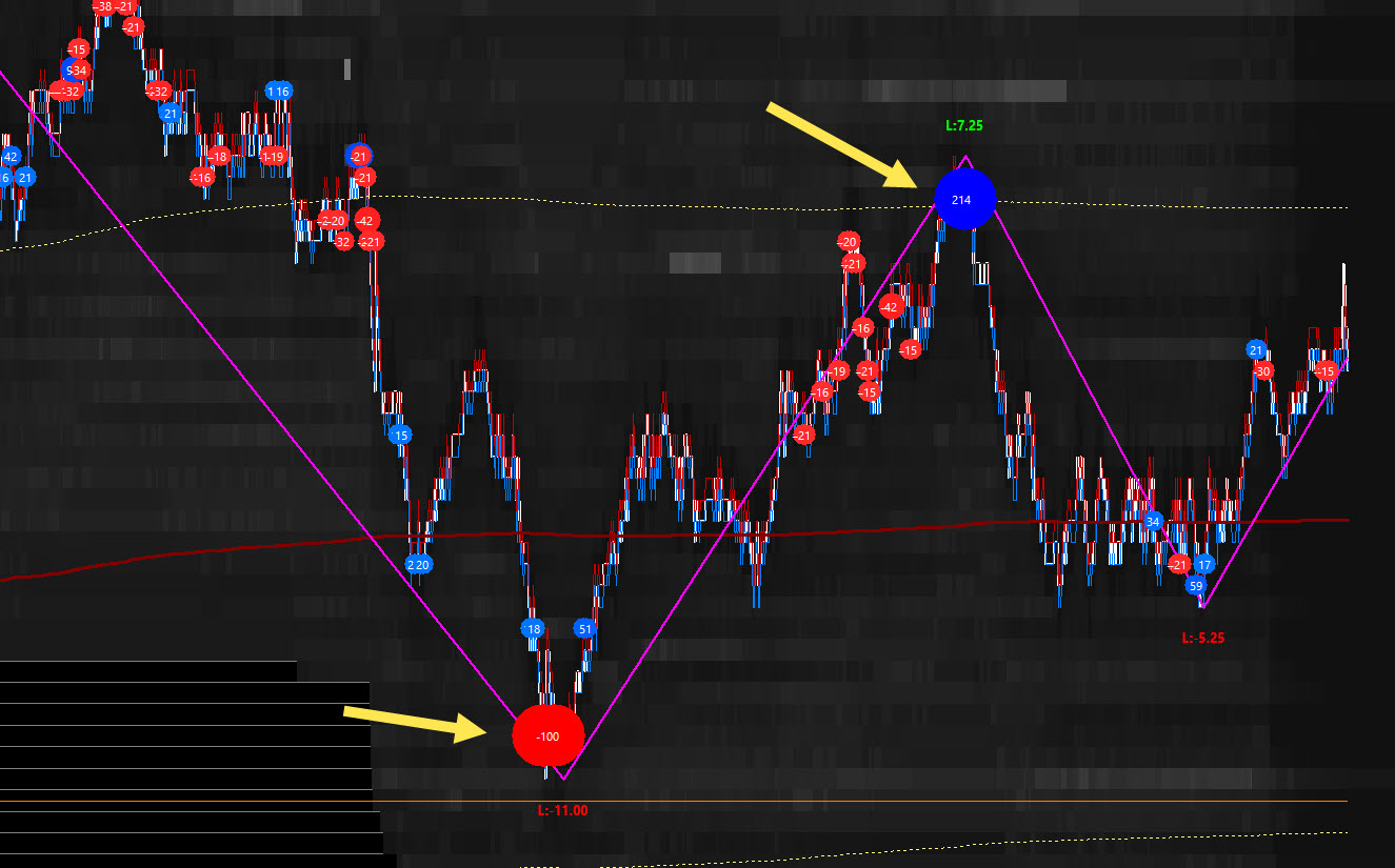

On the very useful LARGE VOLUME TRADE INDICATOR there is a thing to correct that I think will require little effrort from you and could imporove the indicator a lot:
As you can see from the image attached the automatic sizing of the Circles is made comparing the blue ones with the blue ones (ask) and the red ones with the red ones (bid) that are in a specific moment showed on a chart.
This gives a non immediate correct vision of what is really happening.... you see the -100 circle (bid trades) and the +214 (ask trades) with the same cirle size that is not the case to have a clear immediate vision, so why not simply adjust the sizes comparing the ABSOLUTE VALUES so it takes into account bid and ask ? so in the above example the ask one (+214) will become the double in size comparing to the bid one (-100).
I suppose it should be not a big change for you..
If it can be adjusted on the next updates it could be a really good improvement
tks
regards

[2023-06-29 13:57:52]
We have set this as a Feature Request.
We can not say when, or if, we will get to any particular feature request.

[2026-02-23 01:04:44]
Sierra_Chart Engineering - Posts: 25489
This has been implemented in the latest prerelease of Sierra Chart. Update to the latest prerelease.
[2026-03-24 10:03:08]
User75949 - Posts: 142
Thank you, tested it and they work fine.
