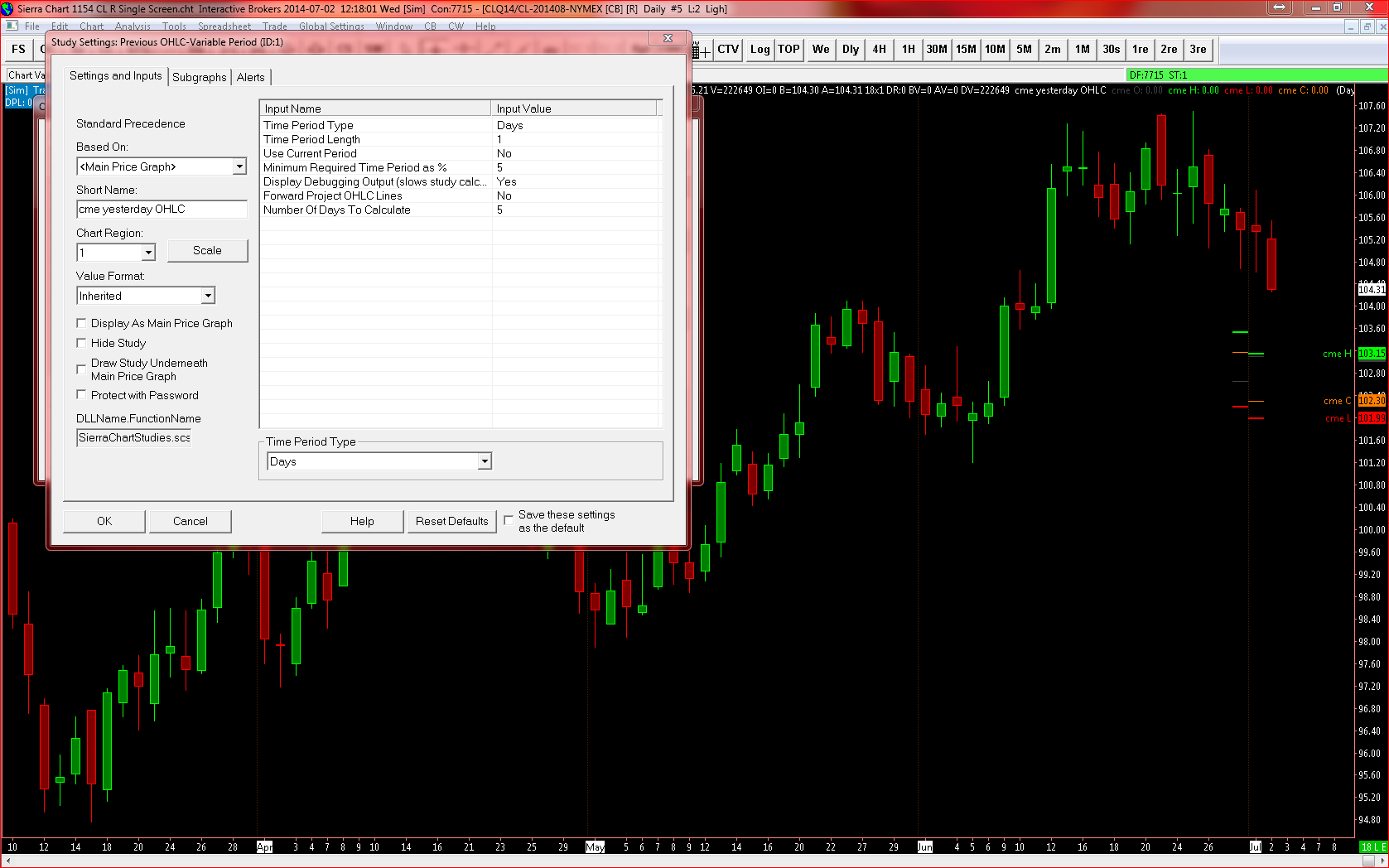

I am using SC Historical Data specifically (not sure if intra-day charts drawn in a daily / weekly format have this issue) but here is the problem.
It will not plot yesterday's OHLC?
Settings:
Time Period Type: Days
Time Period Length: 1
Use Current Period: No
Min Required Time Period as %: 5
Display Debugging: Yes
Forward Project OHLC Lines: No
Number of Days to Calculate: 5
See attached screen capture (CL August futures daily chart). It plotted the OHLC of some random day? I guess my questions are as follows:
1. The faulty plot is plotting something a month ago - just eyeballing and not tested as yet.
2. If I plot the previous week OHLC on a daily chart, it seems to work. However, if I try to plot the previous week OHLC on a weekly chart, it will not work and same problem?
So it appeared less likely that I am using it wrong and something wrong with the study? Please help.

[2014-07-03 04:31:21]
In the next release you will find a new input with the study called "Auto Skip Period of No Trading". You will need to set this to No to solve this problem.

[2014-07-08 17:04:17]
What you see does make sense when not automatically skipping a period of no trading.
The problem is the study was not designed to be used on chart bars with the same time frame as the period the study is set to. This is the underlying problem.
We will see if there is a solution to this.
