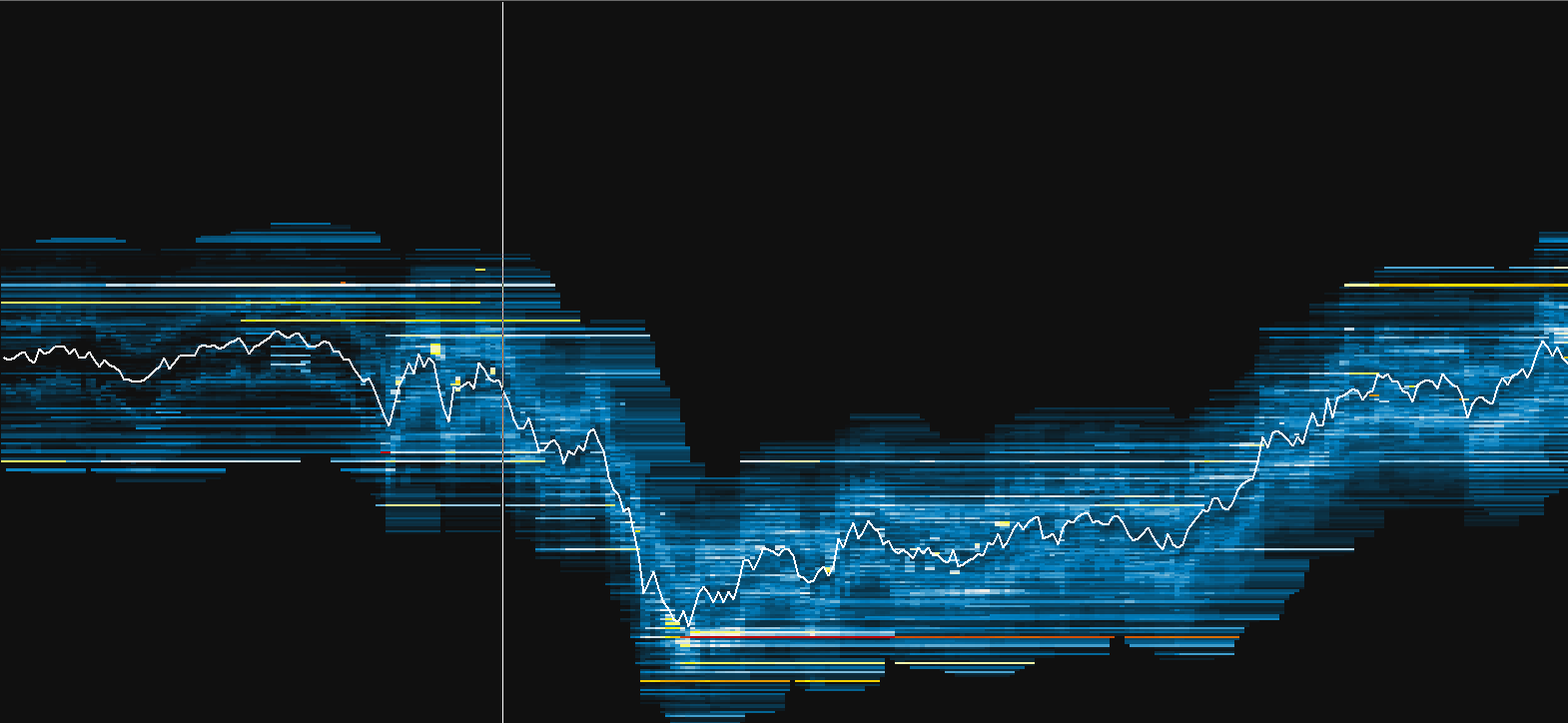

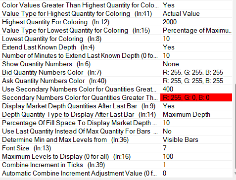

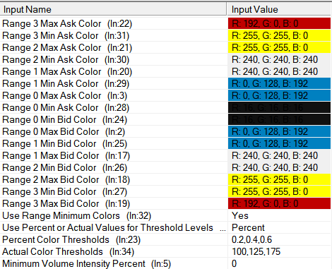

I came across a situation yesterday on ES at approximately 1:30pm where very anomalous resting orders were placed in the market at the 4442.75 level resulting in the rest of the chart becoming a "black hole" with no colour gradients due to such a large discrepancy, in the 3000 lot range compared to a typical several hundred or less. In the documentation I came across the setting "Value Type for Highest Quantity for Colouring" and Highest Quantity for Coloring" Settings but cannot seem to make it work correctly to affect change that works appropriately beyond this specific area in the chart.
I've uploaded two screenshots of the current settings and was hoping you could help which I believe are pretty standard. Thank you

[2023-06-21 13:51:30]
Sierra_Chart Engineering - Posts: 25005
Try setting this to a much smaller number like 20:
And see if it makes a difference.

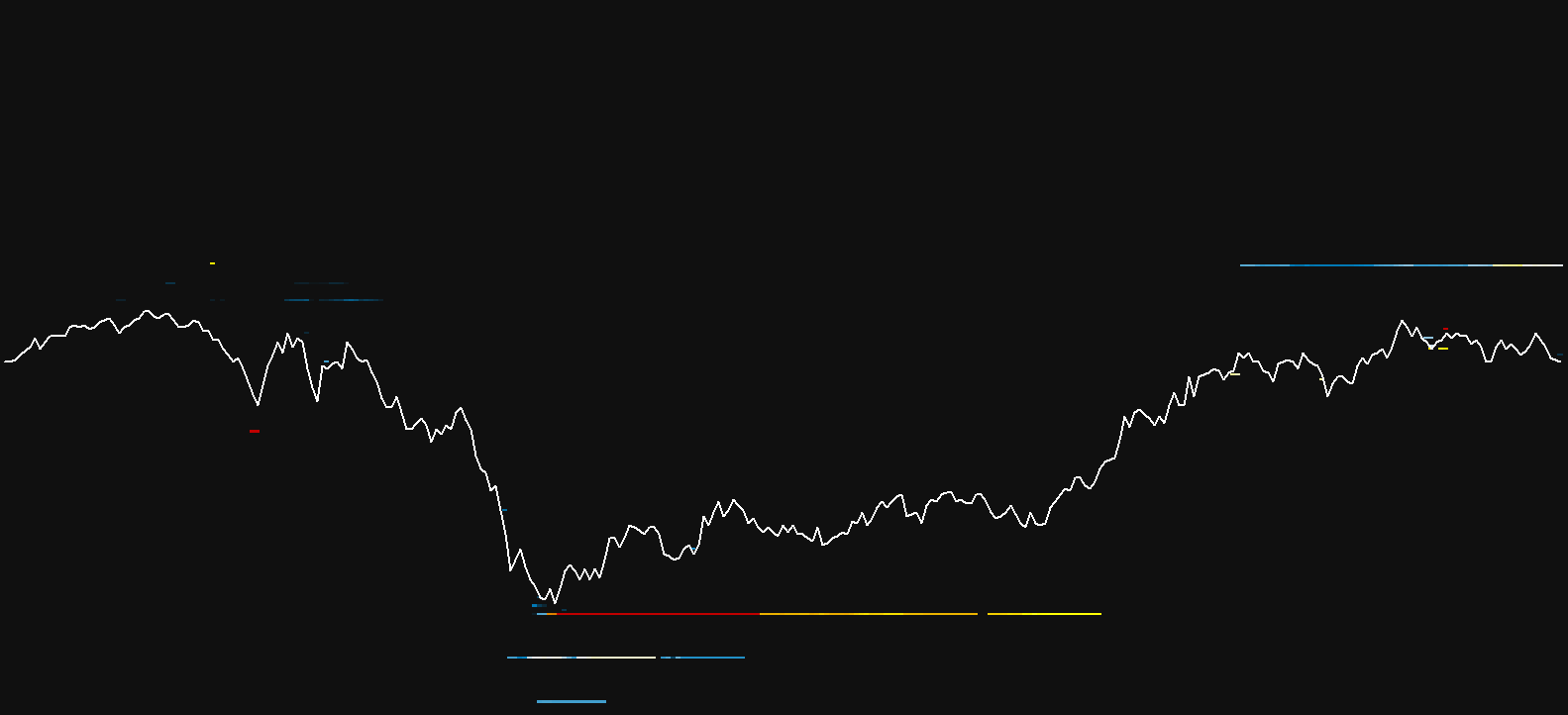

hmmm, seems like setting it to something so low jsut leaves the chart unusuable. Everything is Max 3 colored then. If I set it to 500 on ES its more usable as a standard setting but as soon as those outlier prints come it becomes rather useless by contrast. I attached what the chart looks like right before the 3000 lot limit area and right after using 500 as max size.
Upon thinking about it, is there a way to set the indicator to use the typical settings but then have anything over the average (or median maybe since a "black swan" lot heavily screws it) just be colored the same Max 3 color? By the description it would seem that the input setting previously mention is the one to manipulate but it doesnt seem to give the desired outcome.
