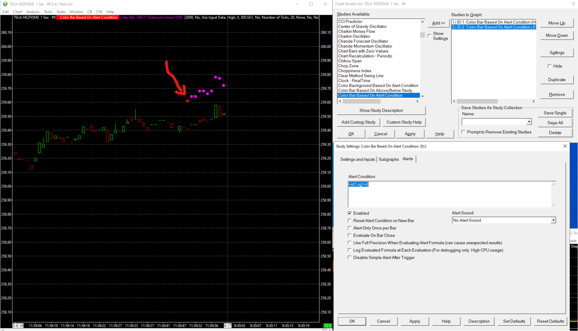

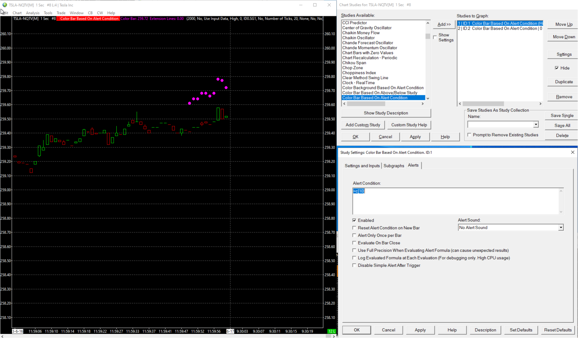

im trying to display only the first point of the 10 points (i mark it in pic "id2")
how can i dissplay only this point?
regards.
imageid1.png / V - Attached On 2023-06-20 12:37:38 UTC - Size: 365.73 KB - 331 views
imageid2.png / V - Attached On 2023-06-20 12:37:55 UTC - Size: 384.62 KB - 322 views

[2023-06-20 13:11:43]
Sawtooth - Posts: 4361
how can I display only this point?
Add another Color Bar Based On Alert Condition study
- Set 'Number of Bars to Calculate' to 10
- Use this formula on the Alerts tab:
=ID2.SG1[9]
- Hide your ID2 study.
[2023-06-21 10:16:56]
User278398 - Posts: 296
thank u for this :) it worked!!
just for understanding:
if i am using your solution
i can need to use only (no need id2,id3)
id1 : Color Bar Based On Alert Condition study
- Use this formula on the Alerts tab: =c[9]
and it worked as well.
i am using lots of color bar based on alert condition study,
and i prefer no to use the "trick" by change "number of bars to calculate"
i want to use only formulas and simplify it (if it can):
1: do u have another solution only with formulas ( in the alert tab) to get what i need?
*** there is way to use only 1 study1 study: Color Bar Based On Alert Condition study,
by using the Alerts tab
and get:
2.the first 10 points (as i display in pic "id2", (but not as i success by 2 studies).i want to
simplify my future solutions
3. only the first point of the 10 points (as my origin question)
i bothersome u with those questions because in logic i cant understand why there is not a simple way by formulas.
how can be simple formula as "=c[10]" which display me all the points beside the first 10 points,
but there is not a formula to get the first 10 points,
there is not a formula to get only one point in the position number 10 (as i need),
there is not a formula to get two points in other position(in position number 10 and number 9)
many thanks
[2023-06-21 12:28:59]
=C[10]=0 did work in the past, but SC changed something, so now you must use a second instance. See this:
Hide currently forming candle
You found a way by using:
Use my original solution in post #3 with this formula:
=ID2.SG1[8]
These are no other simpler ways to do what you want.
